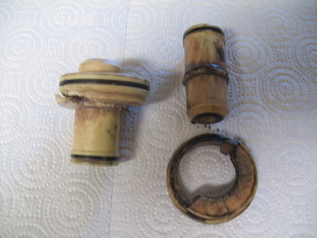

Here is a pic of the two failed accumulator pistons. I have no idea whether they are the factory units or a aftermarket replacements since both trannys were rebuilt at some point.
CHECK/CHANGE YOURS BEFORE IT LEAVES YOU STRANDED!! It's not too difficult and can be done without removing the trans. Remove the pan, valve body, and a snap ring and it's otta there.
