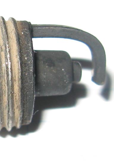

I decided to replace the #1 Plug. Sure enough it was fouled up. Van runs much better now.
