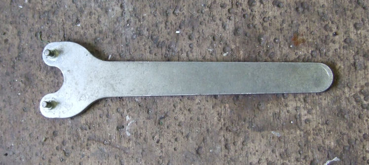

dude a grinder wrench works like a charm
http://www.gerrelt.nl/achterremmen/a...der_wrench.jpg
few turns ull be there
