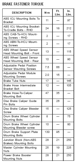

For my 2006

I find it hard to believe a junkyard didn't have one minivan that you could have pulled a bolt and compared to what you needed. it doesn't necessarrily need to come from the exact same year make model, you just might find the same bolt on a different vehicle.
I don't see anywhere on that list where is says brake caliper bracket to spindle torque spec (most cases it's upwards of 100ftlbs)
I can't believe the dealer doesn't have the torque spec!!!! they have shop manuals!
