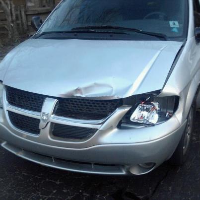

Ok, so my wife hit a deer. Damage done to front driver's side. Insurance totaled it. I thought "rebuild?". I have owned this van since new.
Exterior needs new hood, headlight, and plastic bumper. Front quarterpanel can be reworked, I think.

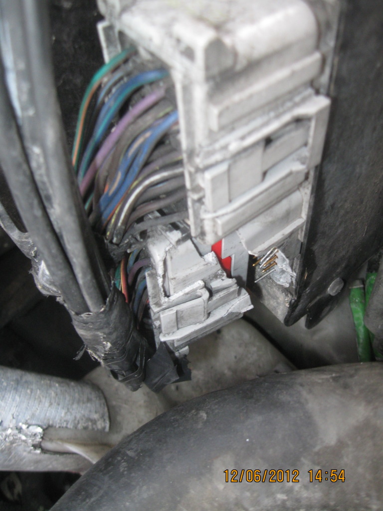

The ECM has a busted connector but I will try to salvage it and see how it goes. The ECM and the wiring harness (wiring harness does not need to be replaced) is what busted the cap on the insurance limit.

Rockauto.com and good luck. I hope the ECM didn't short out.

There is a seller on eBay(I think it is autocomputerexchange) that is pretty sketchy to deal with for your ECM if it comes to that. NAPA is supposed to be a good source for the ECM.

I have wiring harnesses for the PCM connector if you have the patience to change the connector. It's not hard, just time consuming. Also, I have delt with Auto Computer Exchange and have one of their units in a 96 Plymouth Voyager working just fine.

The damage doesn't look that bad. Are you planning to repair the front bumper or replace it? It looks like it was torn but all the pieces seem to be all there.
