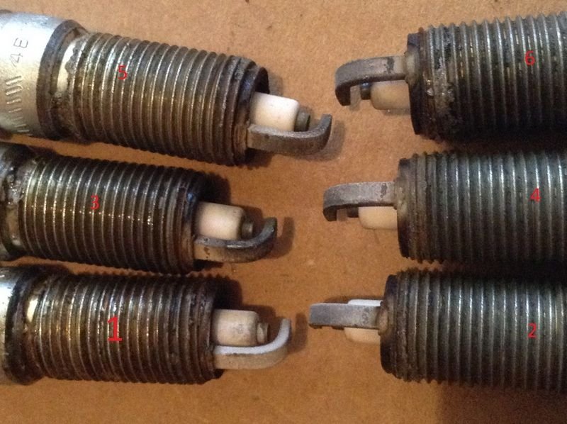

here are my dry compression values and pics of the spark plugs
cylinder 1 spark plug appears whiter then the others, not sure what that indicates, all advice greatly appreciated

after changing the miss did go away, chance could have been just the plug
