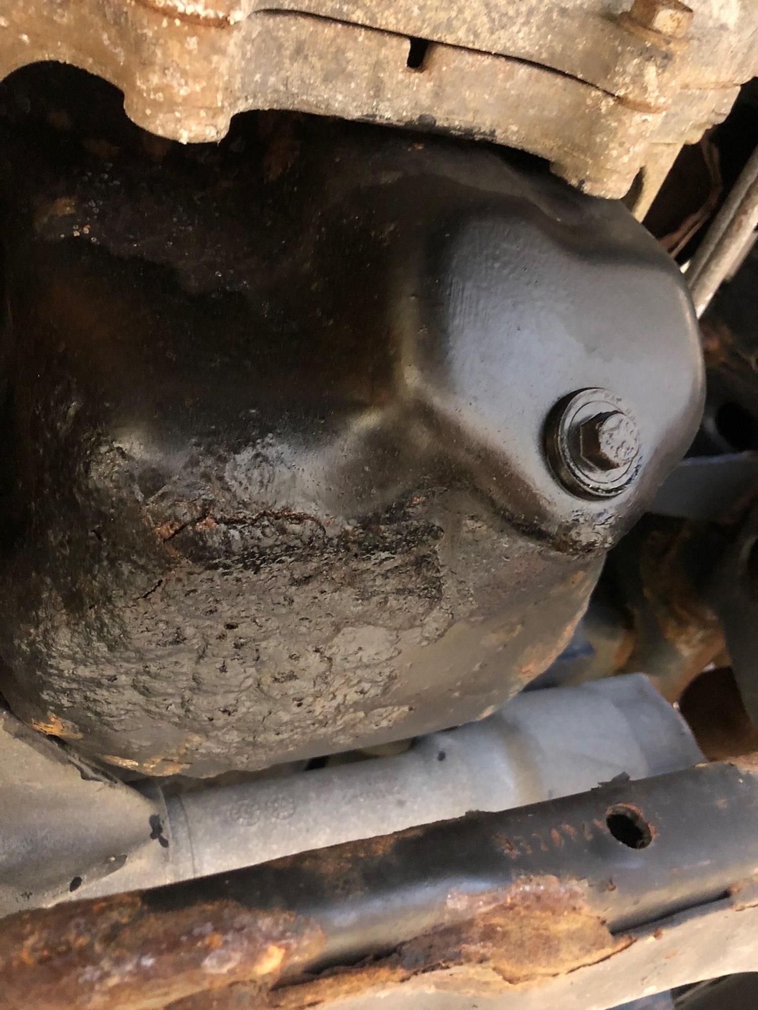

RamedHemi's Avatar
RamedHemi
Posts: 247
Default Rusty pan
The whole thing is covered in rust. The bottom, around the plug, and the whole upper part of the pan also. Great craftsman ship here huh. I do not think this is even repairable. The block is so rusty pieces are falling off of it.
