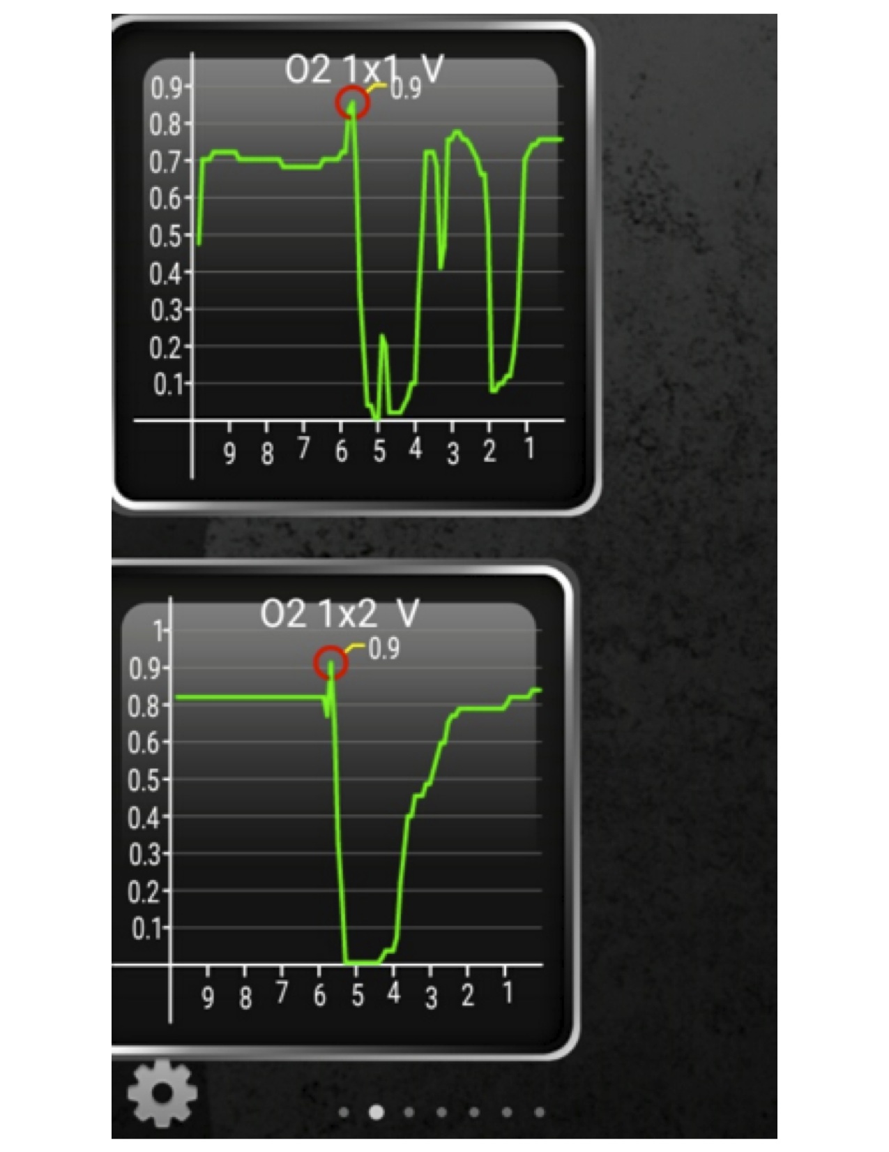

These are 02 sensors 1 and 2. I have 0420 Cat less then efficient. It doesn't appear to be less then efficient because my downstream 02 sensor is not mimic of #1 sensor according to videos and info. read.
There are four attachments. First is a snap of #1 sensor upstream.
Second is a 2000 rpm shot of #1 and #2 02 sensors.
Third is at idle taken after 10 mins and fully warmed up.
Fourth is another shot of idle fully warmed up but turned engine off and then started back up 5 minutes later.
I believe that #1 and #2 are compared with computer of van to determine if there is a CAT inefficiency.
Do i have a lazy enough sensor #1 to cause the computer to send 0420 CAT code when in fact the #1 sensor is bad thus giving wrong info. to computer, thus I have a good CAT just a bad #1?
