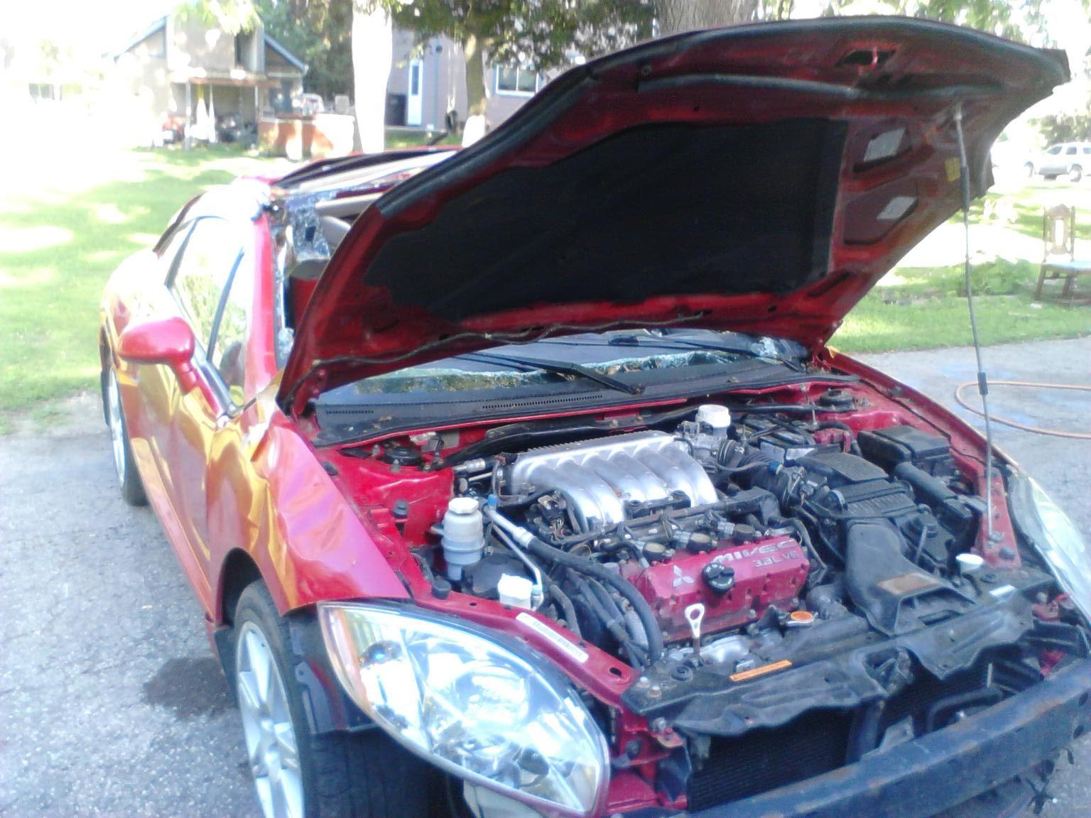

So I got a steal on a complete (well mostly) 07 Eclipse GT, so I now have a new project.
The 6G75 is going in my Voyager. Hoping to be able to use the whole driveline, but it may end up mated to my 670, still mowing this one over.
Insight as to what I'll need would be greatly appreciated.
So far the plan is to use the Mitsu ECU and wiring, swap my ignition to the Mitsu unit, hopefully use the complete driveline as they seem well matched.
Here's the donor
I'll update as I dig into this project, got a few things to take care of before I start into this real far.
