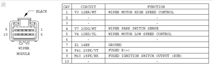

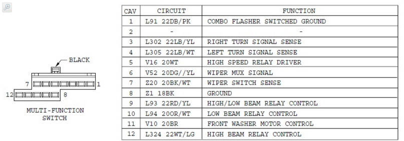

Yes it is: date of manufacturing is 12/1995 and the front windshield washer is not working correctly. And the washer does not work when wiper speed is set to slow. I asume I have got the US version of the dodge grand caravan.
But - I think I have two relays ...
I will attach two pictures from a german crack mechanic ...
(maybe (t)here is an other user with the same problem)
One of the relays will switch the wiper ON and the other will switch between LOW and HIGH. Isnt it?
Thx and I will write a pm. Stephan

Ok, windshield washer it is. Unfortunately, I've never heard of a washer problem related to wiper speed. That makes me think the system on your van is different from US spec vans. The usual problem is the washer doesn't work at all. In your case I can only guess at the problem. Hopefully, someone else on the forum has seen this and can help you.
Yes, the 2 wiper relays control wiper operation either providing power or reversing wiper direction. I don't see a connection to the washer other than the wiper switch on the multi-function switch sets the ground to the wiper high/low relay coil and the washer circuit is connected in parallel to that circuit. My logic is telling me the wipers are working at all speeds so the washer should work at all speeds. One thing you could try is disconnect the wiper switch connector and using an ohmmeter check for continuity at all the switch speed contacts with the washer switch turned on (reference the wire diagram). If you don't see continuity (no or very low resistance) then the switch looks like the problem. Keep us updated.
