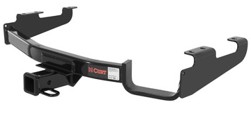

I'm looking to get a Cargo Carrier w/ ramp for my large snow blower. However the carrier wants a 2" receiver Class III/IV hitch. Can my existing hitch be easily removed and upgraded to something like this?

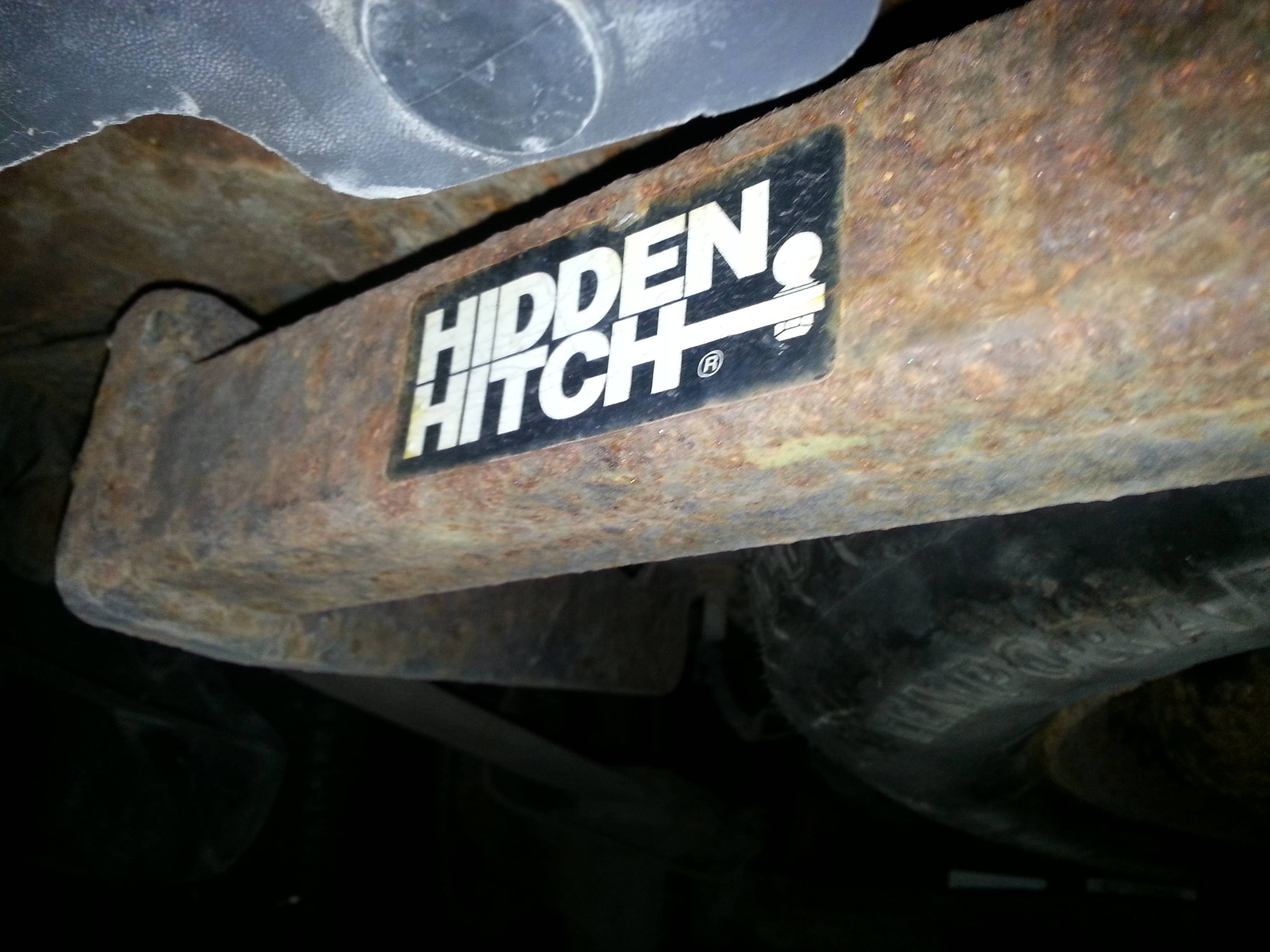

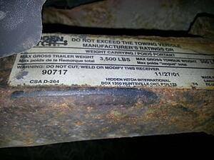

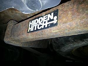

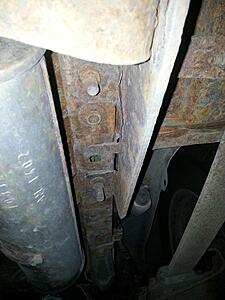

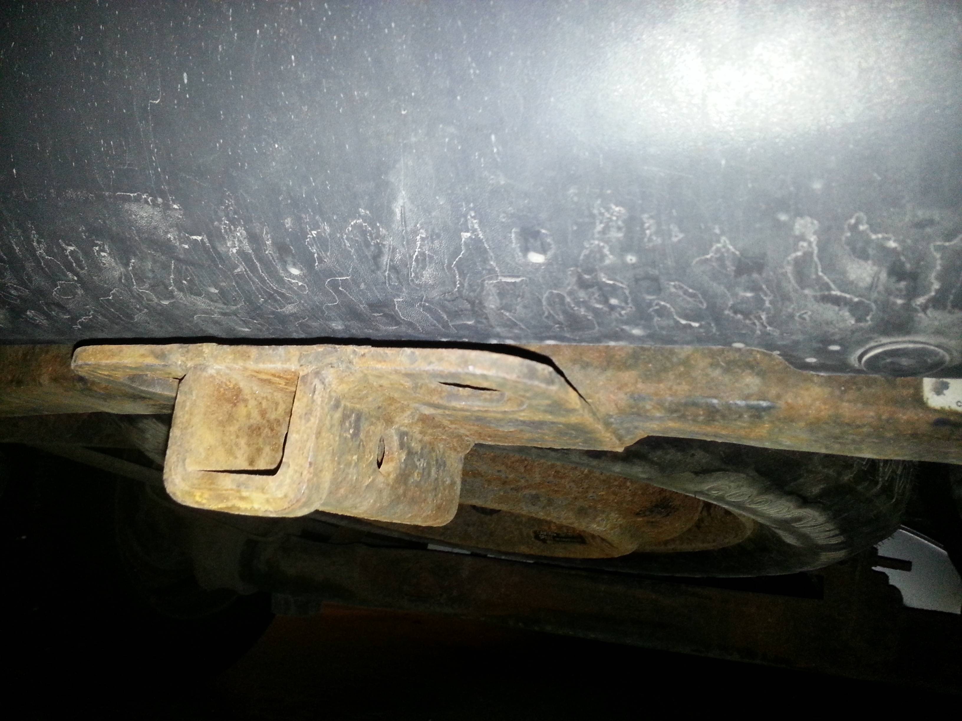

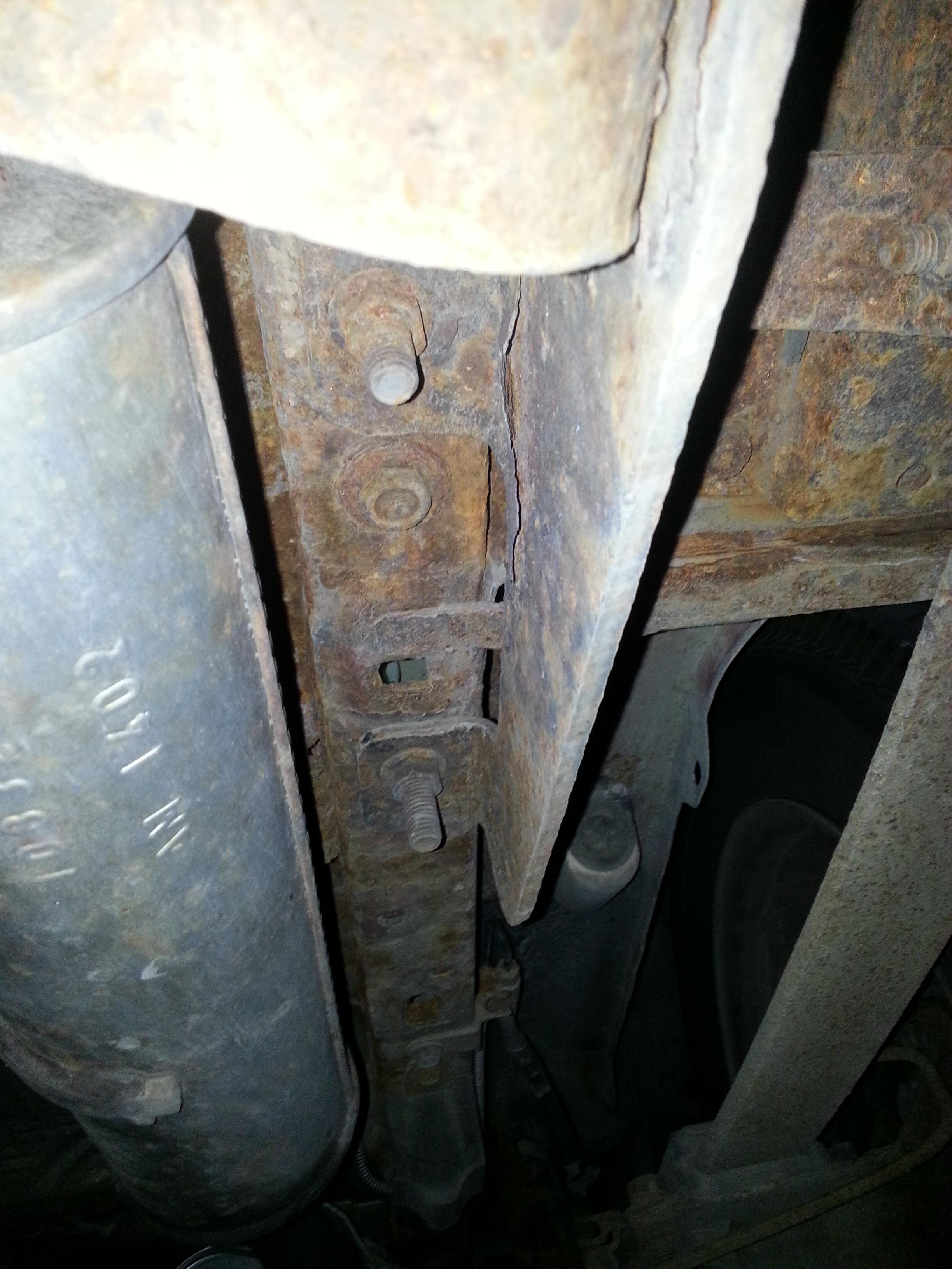

Here are photos of my existing hitch. The existing Hidden Hitch 90717 has a different shape from the Class III hitch shown in my original post above. In my photos below you can see the existing hitch only uses 2 bolts per side. I dont see an extra bolt hole for the Class III hitch but i do see some bolt already screwed in. To be clear that is where the extra bolt would go for the Class III, only i need to remove that existing bolt covering the hole?
