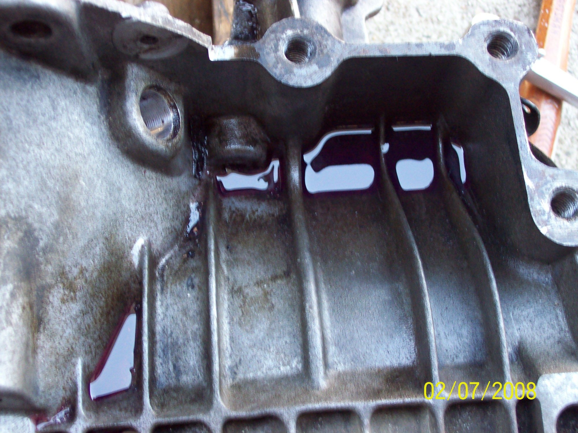

I had the same problem with my 1996 Grand Caravan transmission leak before. I removed the transmission and replaced the transmission seal and it was still leaking. Changed it again with the same results. I removed the transmission the 3rd time and observed it. It was not leaking from the seal. It was leaking from the Front Pump Seal. Remove the bolts and pull out the front pump and there is a big O-ring in there. Got it from the dealership for a few dollars and replaced it. It has been holding up for about 9 years now. I have attached some pictures of the leak.
Leak coming out from the Front Pump seal (big O-ring)
Leak was oozing to the top of the transmission. The transmission oil was coming out of the bell housing too.
