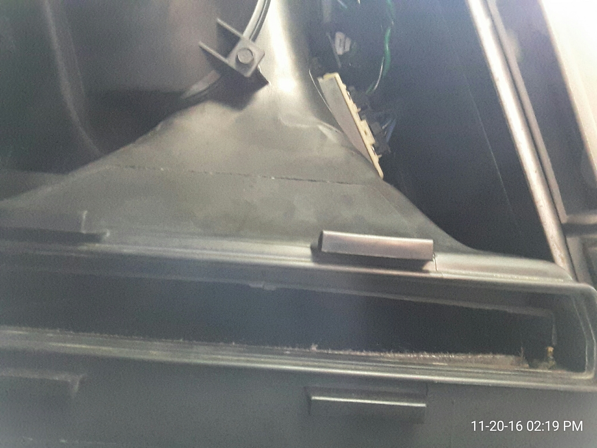

Hi,
I just bought an old Caravan Sport (2002) and I noticed it's missing a cover for one of the vents by the feet of the front passenger. If the vent setting includes the feet, this thing blows a LOT of cold air, no matter if it's set on heat or AC. Next to it is a smaller vent that works properly and blow air through there. But I think the missing cover on this big one is supposed to keep it shut? Am I correct? Can I just ductape it? Or any other more permanent solutions? I tried Google to see what the part is called and maybe I can order it, but nothing came up.
Thank you in advance.
Nadia
Attached Thumbnails Missing vent cover, can I tape it closed?-img_20161120_141924010_zdatemark.jpg   Missing vent cover, can I tape it closed?-img_20161120_141948525_zdatemark.jpg

Looks like a cabin filter slot with the cover missing maybe?

Ditto:

In answer to your question, just go ahead and tape it. You'll just won't have a filter element which many cars don't to start with.

If you do want to replace the cover the part number is 4885463AA.

Yep, that's it! The cabin filter is missing and the cover!!! Thank you for helping me.
