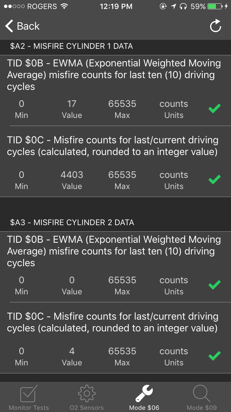

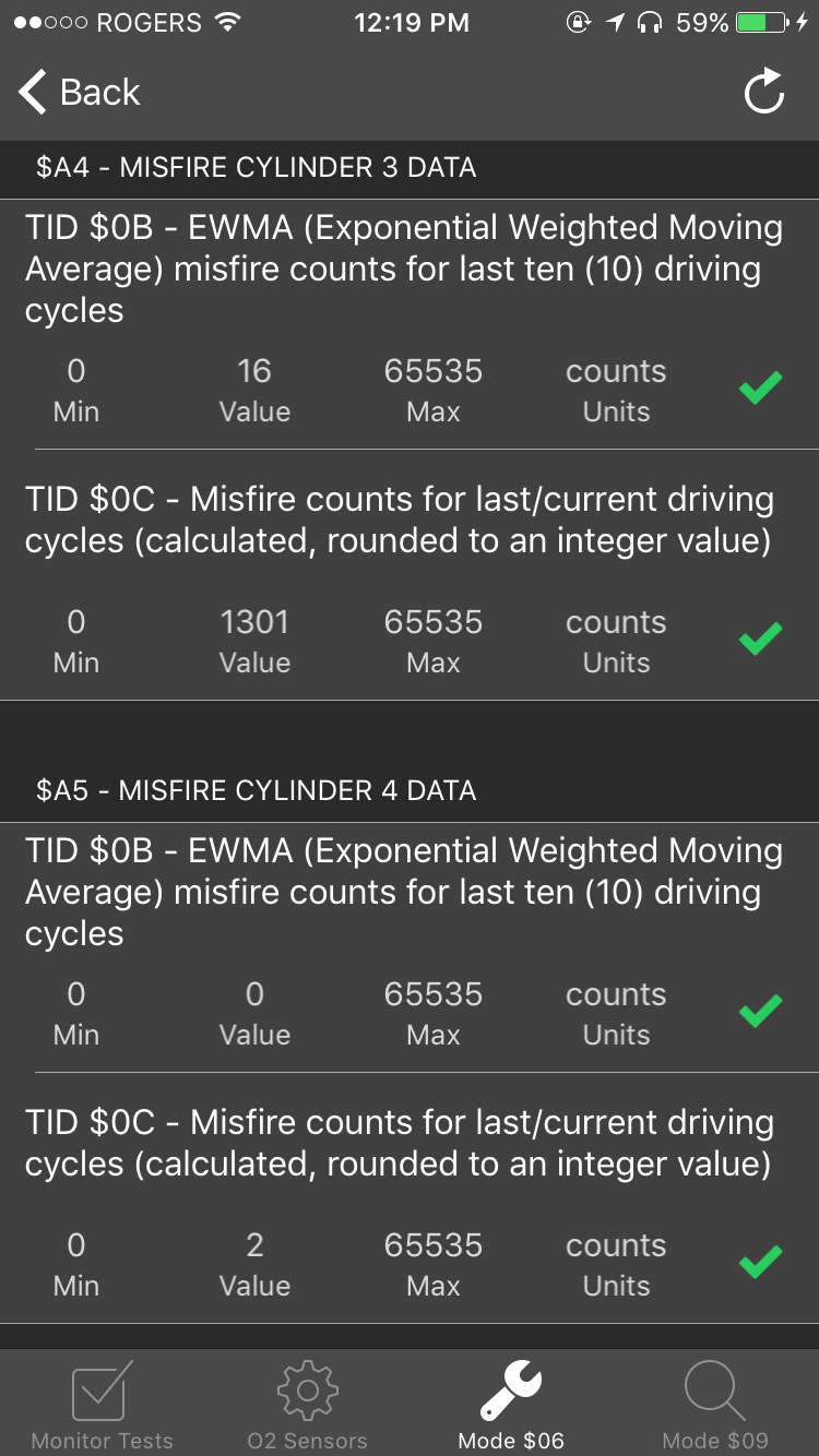

- thousands of misfires in 1 , 3 and 5. Left side has maybe 2-3 misfires total.

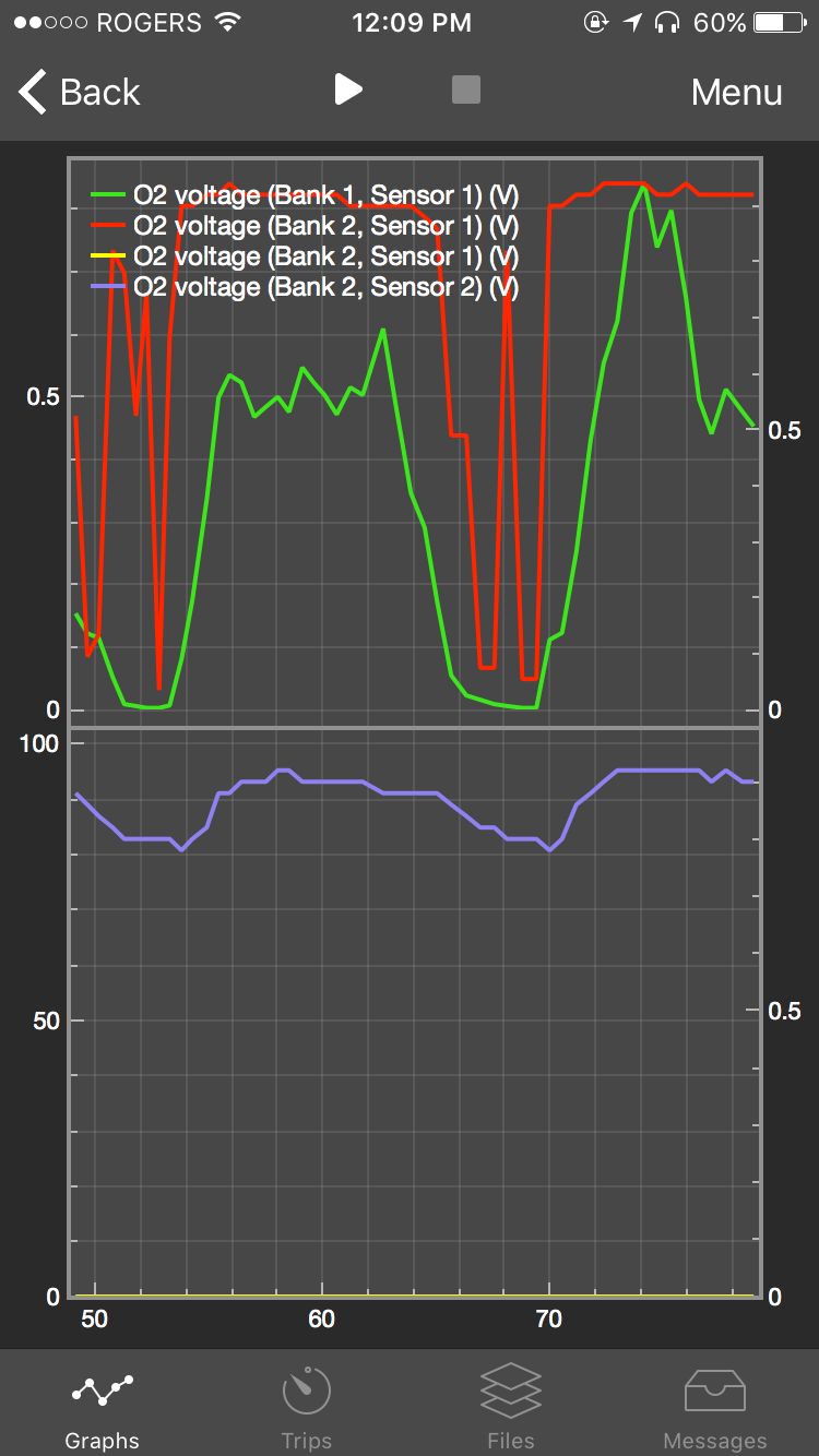

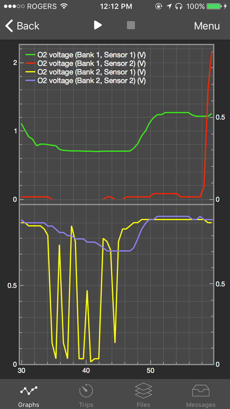

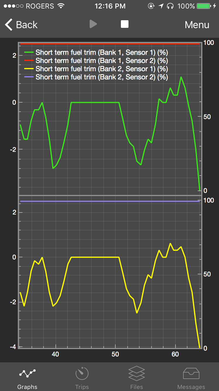

I've attached pictures of some logs from my ODB reader, but I don't really know what I'm looking for.

when an engine is misfiring...02 sensor and fuel trim data are not accurate.
start by swapping a spark plug and coil on the misfiring cylinder. if the fault follow the parts..replace parts. if the fault stays...perform a compression test. if you have low compression, it may need a cylinder head. there are known issues with the cylinder head. if you still have powertrain warranty fca will fix it for free.
