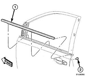

you have an issue with the latch I heard of people saying you can take the strip that runs along top off the door off (see picture) and putting the window in the up position being able to take a long screw driver or some other tool and reach down and manfully work the latch it will take time and patience to do but Ive heard from other techs that it can be done I haven't tried it myself yet
