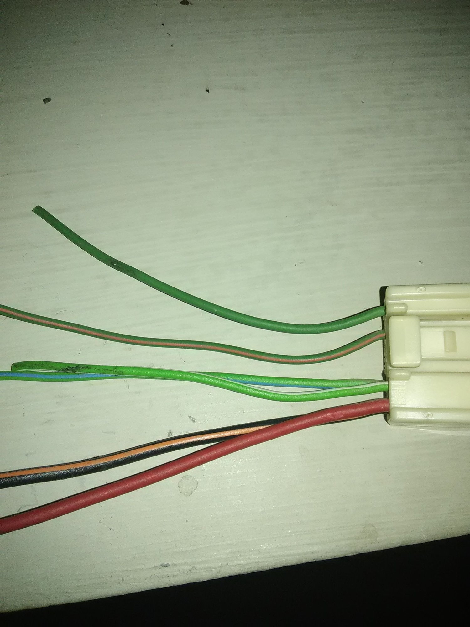

2008 Grand Caravan
Can someone tell me what wire is what on the factory amplifier input plug.
Location of the plug is under the Driver Rear 6x9 speaker.
Wire colors:
Red
Black/Orange
Green
Green/Pink?
Green/White
Green/Blue

I think you got the wrong plug, that appears to be the plug for the inverter module (located in the same general area).
You can find information about most connectors on your van here: http://connectors.dcctools.com/home.htm

Does anyone know where I could locate the plug for the sub amp (if its even there in mine) What I'm hooking up in an amp out of a Navigator. Its a small amp, I need a constant 12v and a 5v for the remote turn on. and ground. I can tap into the rear speakers for the signal if need be. I was hoping that was the plug for the amp...

The amplifier connectors (there are two) are located on the same side as the inverter but further back (behind the cubby above the jack compartment cover).
You can get the wiring information at the site I linked to above: http://connectors.dcctools.com/home.htm
Enter your year and platform, click "Find Now":
Type "ampl" in the filter field:
Click the links to see the wire colors and functions.
