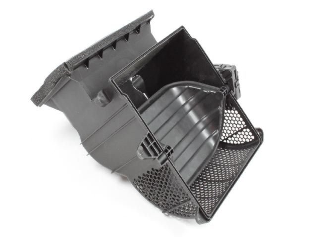

The problem was not that the splines on the actuator or the shaft had stripped. The door shaft had broken just inside the "cage" of the air inlet housing on the actuator side.
Of course, for all of the googling I did, I couldn't find JUST the door. I could only find the air inlet housing assembly - can't remember which website I got it from but it came with the housing, recirc door and actuator.

All the service information I looked at stated the HVAC housing assembly had to be removed in order to replace this part. That meant pulling the entire dash and instrument panel assembly, recovering and recharging the AC and draining and filling the coolant - basically an all day job. Although I did have access to all the tools and equipment necessary to do this (and it wasn't the first time I'd removed an HVAC housing either), it looked like there was enough room to remove the air inlet housing without pulling the entire HVAC assembly, so I decided to give it a go.
Removing the torx screws that secure the housing to the HVAC assembly wasn't too difficult. What the above picture doesn't show is there is an "ear" on top of the housing that is secured to the dash with an M6 bolt - I had to remove the upper dash pad to access it, but even so, it only took about an hour to get everything apart.
Unfortunately, it was not meant to be. For as much wiggling, pushing, pulling, twisting, etc.... the air inlet housing would not come out while the dash and HVAC assembly were in place. And then it dawned on me that I didn't NEED to replace the entire housing - it was just the door.
I was able to flex the recirculation door enough to remove it from the air inlet housing and pull it out from between the inlet housing and HVAC assembly. I did the same to install the new one. I used the new actuator that came with the new housing just to avoid trying to re-align the old actuator in the right range of motion. Once I got the inlet housing reinstalled, I tested the fix before reassembling the dash and it worked normally.
