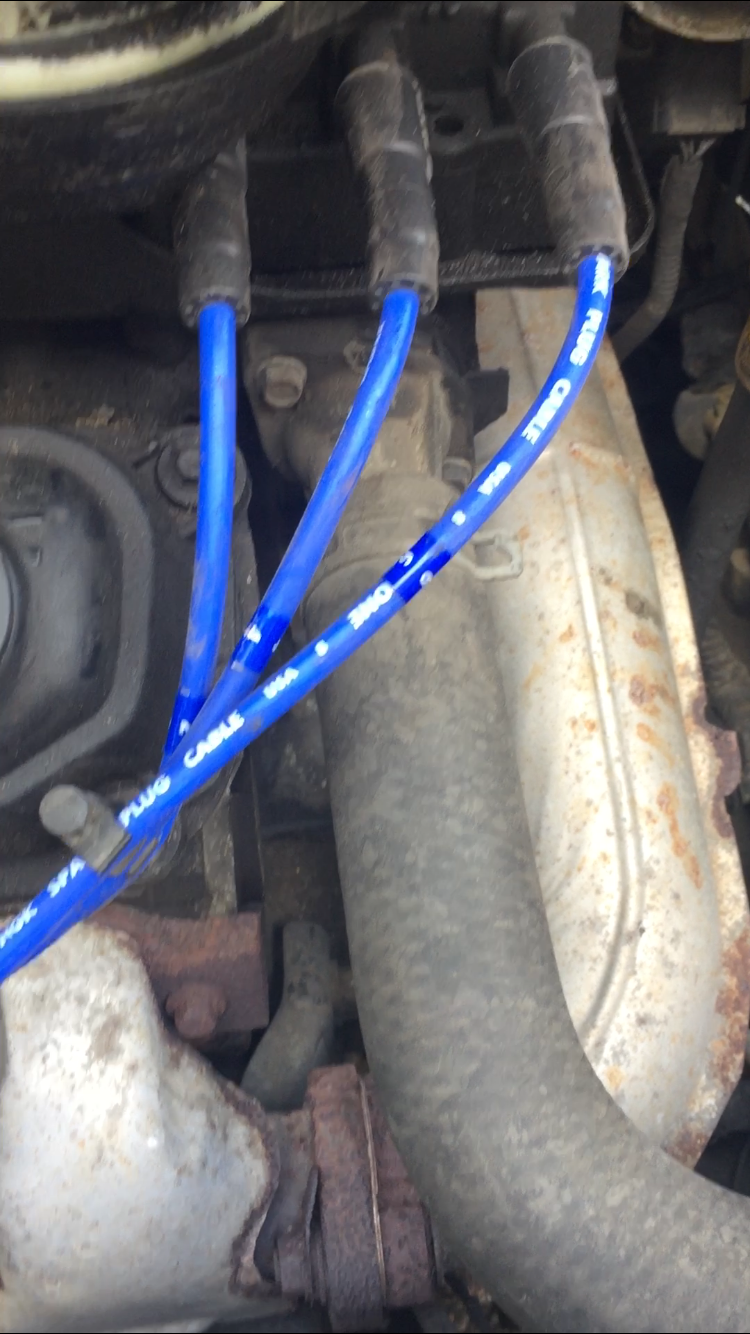

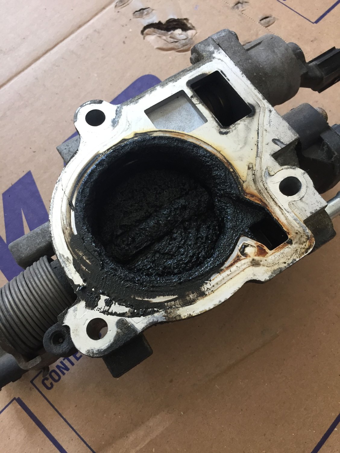

Replaced spark plugs and cleaned throttle body ... look how caked it is .... had an error code after P0113 but was because air intake sensor plug wasn’t clicked right in ...

Yikes! Did it take a hammer & chisel?

No ... but some serious scooping out with a rag ... went through a bunch of rags though

If the TB was that bad, the rest of the intake is probably nasty too. If you notice drivability problems again, particularly at idle, you should try induction cleaning the intake to help clean the carbon off the valves as well.

Yea good idea ... looking in behind throttle body once off ... it did look a bit grimy ...
