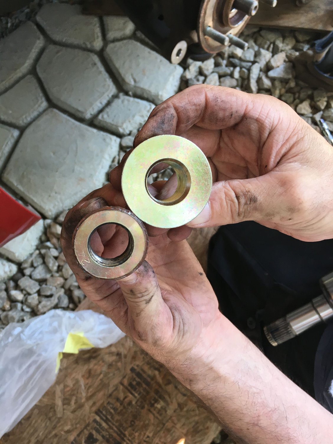

So I got my big socket and breaker bar ready for a fight. Slide it on the nut about the 10 o'clock position ready to stand and bounce on it. Let go and it just hit the ground. Nut wasn't even that tight. The nut the Dodge place had on it wasn't but maybe 1mm bigger than the hole its self. The nut that came with the new axle was way bigger than the old one and had lots more mating surface to tighten to.
And thanks primem I got a good 120 FT LBS on it!
