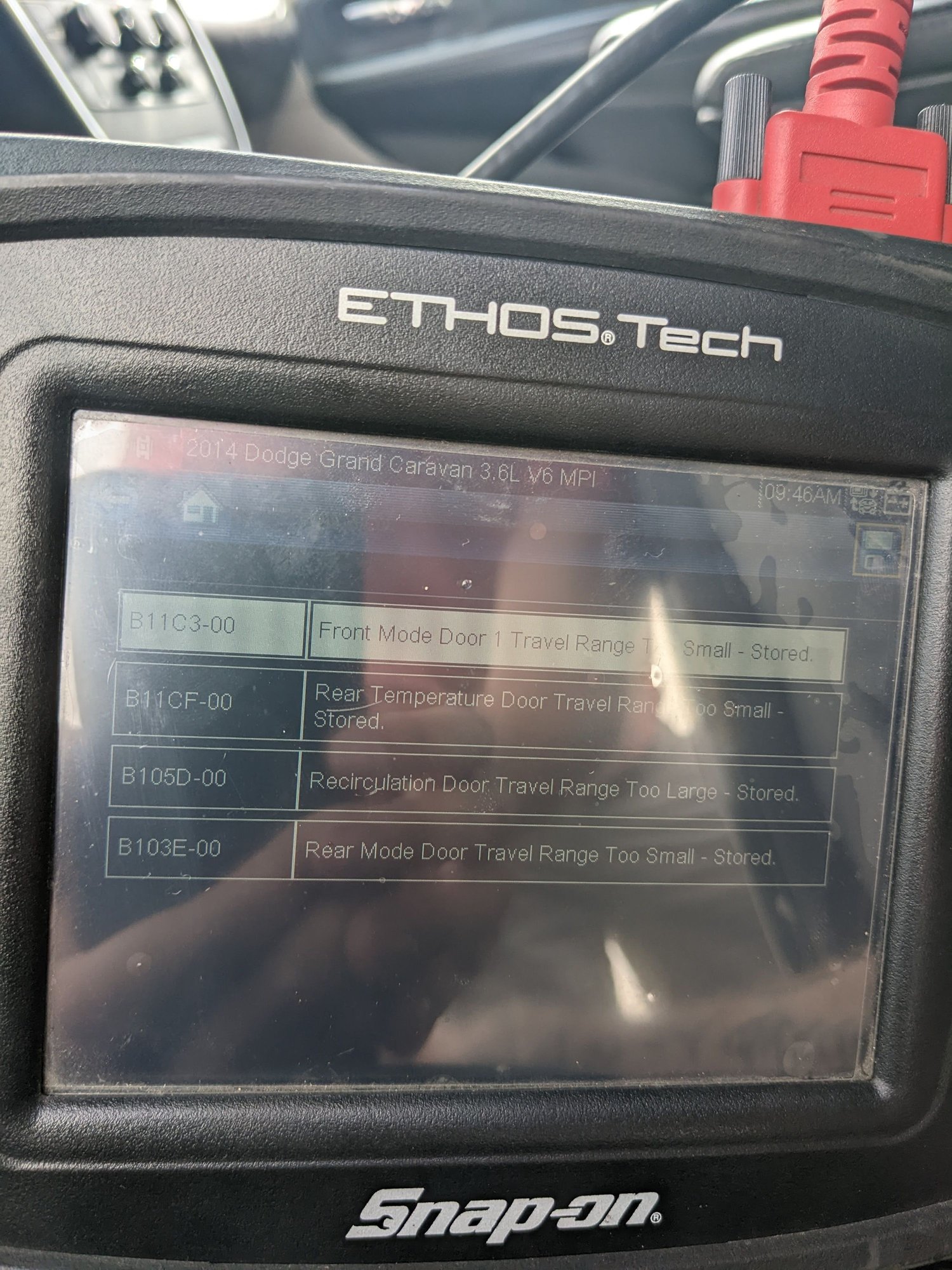

Have had the typical flashing defrost light along with heat stuck on the passenger side and in the rear. Have replaced 2 front acuators with oem parts. Still having the same issues. Then I had a friend run the HVAC codes on his computer and the results are in the pics. Looking for advice on making sense of what the codes mean.
