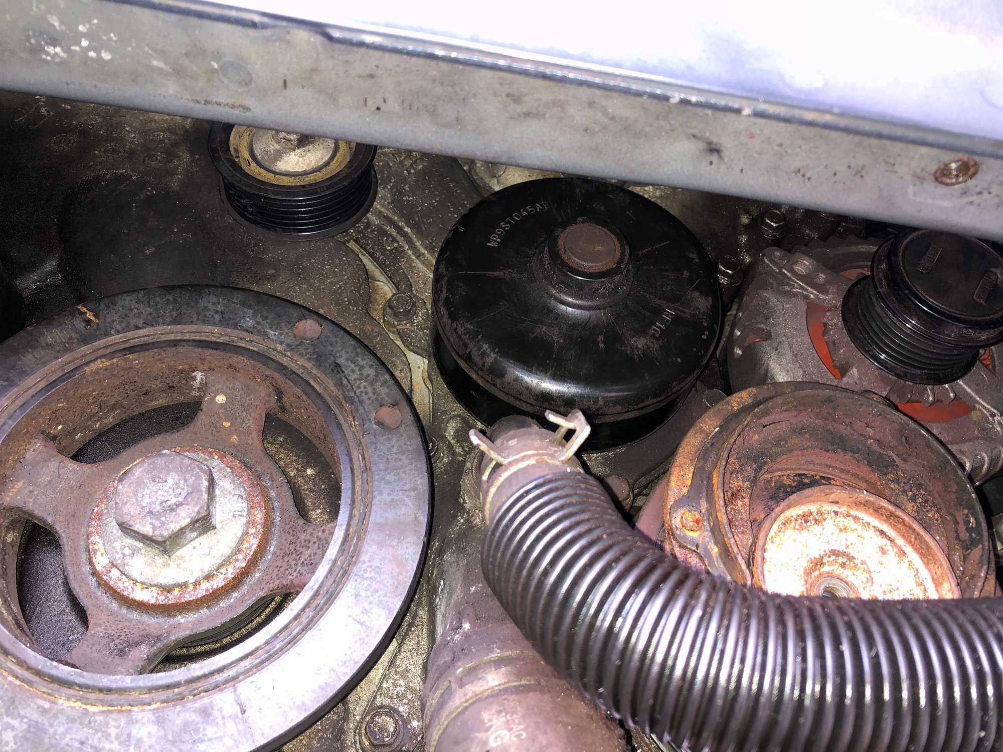

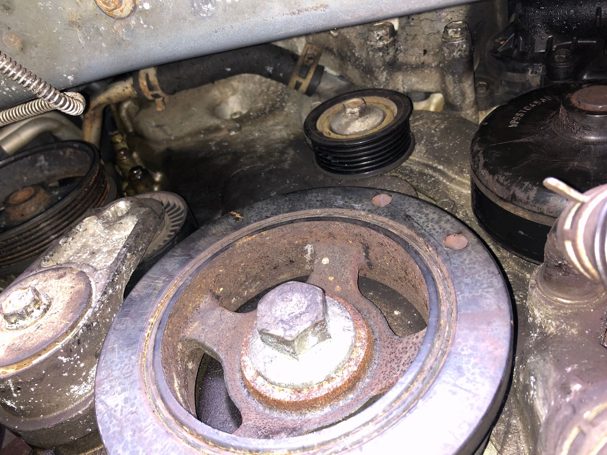

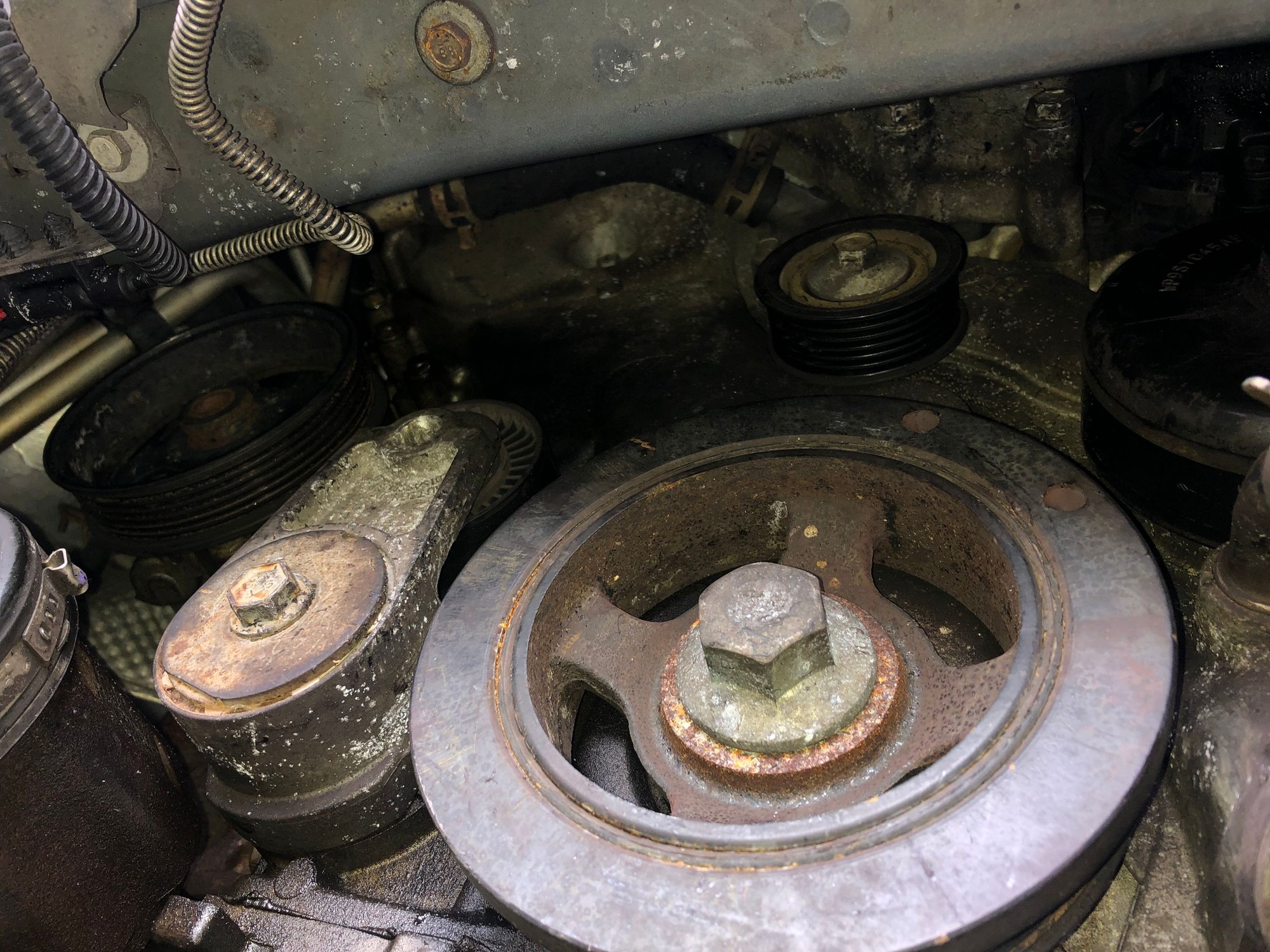

I have a 2011 Dodge Grand Caravan 3.6 Liter R/T. My AC Compressor seized and I am going to bypass it. My problem is I went to Autozone and got the same exact size as the original belt which is obviously no help. Do anyone know the exact size I’ll need to use to bypass the AC?
