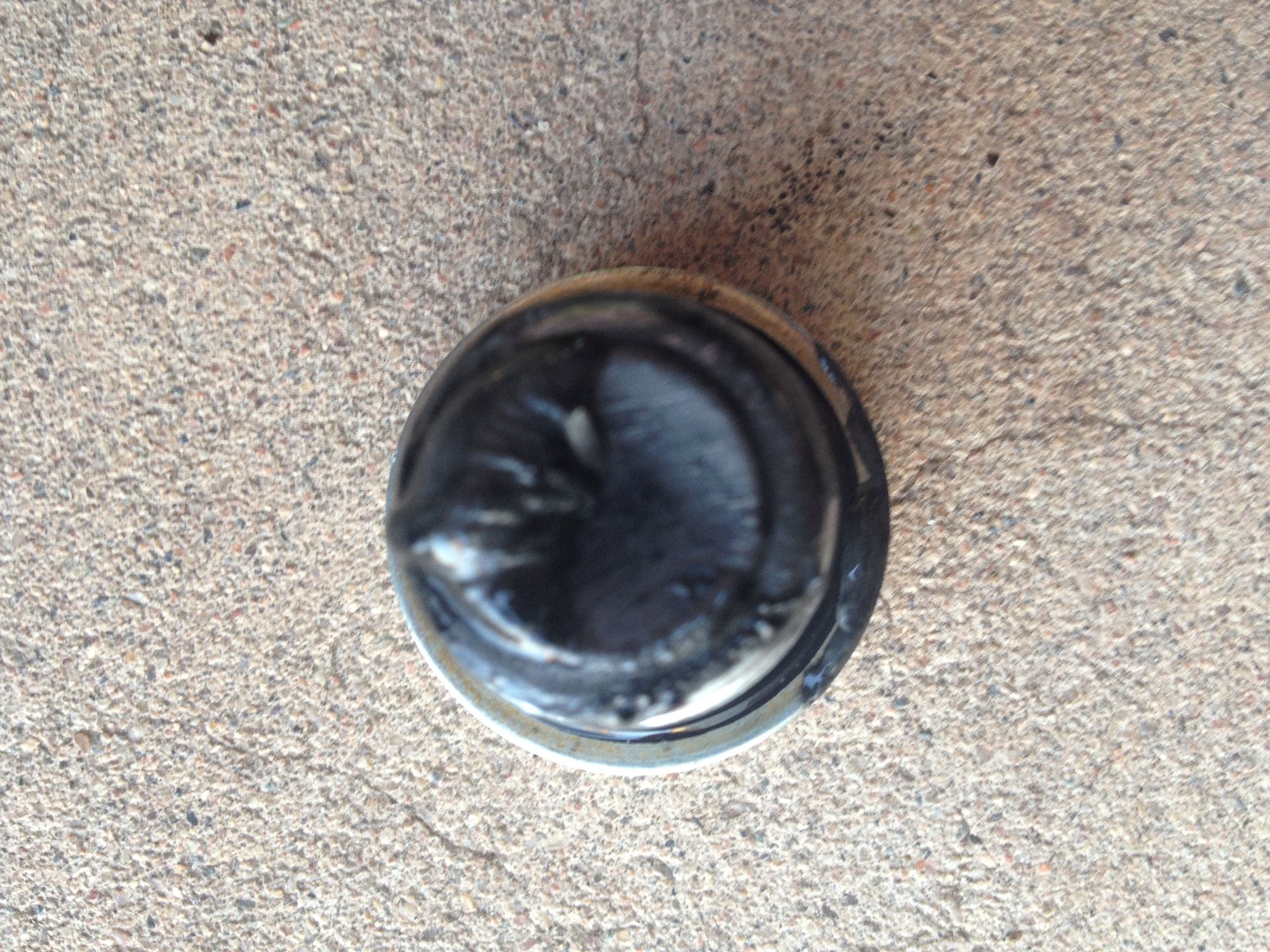

Since originally posting here I bought an endoscope and was able to take the following videos internally:
You can see the excessive backlash. There is definitely something strange going on with the wear on the pinion drive side- almost as if there is insufficient surface hardening which would explain the source of all the metal shavings I found on the drain plug after only a couple thousand miles driving (photos attached).

There is way too much slop at the spider/side gears, and way to much backlash in the R&P.

Hi, yep I agree the measurement at the coupler is not a true backlash measurement but at least it is an indication.
I got the car with only 12 or so miles on it so I doubt if joy riding is the culprit though even in 12 miles someone could have done something stupid. Looking at the wear on the pinion teeth and the fact it went from no noise to lots of noise in 400 miles makes me think the pinion depth and R&P backlash was not set up correctly from the factory and it wore through a bad contact pattern and all the subsequent hammering has damaged something in the spider/carrier assembly.
Part of the problem is that these units are not really serviceable and from what I understand the dealers just replace the whole thing.
