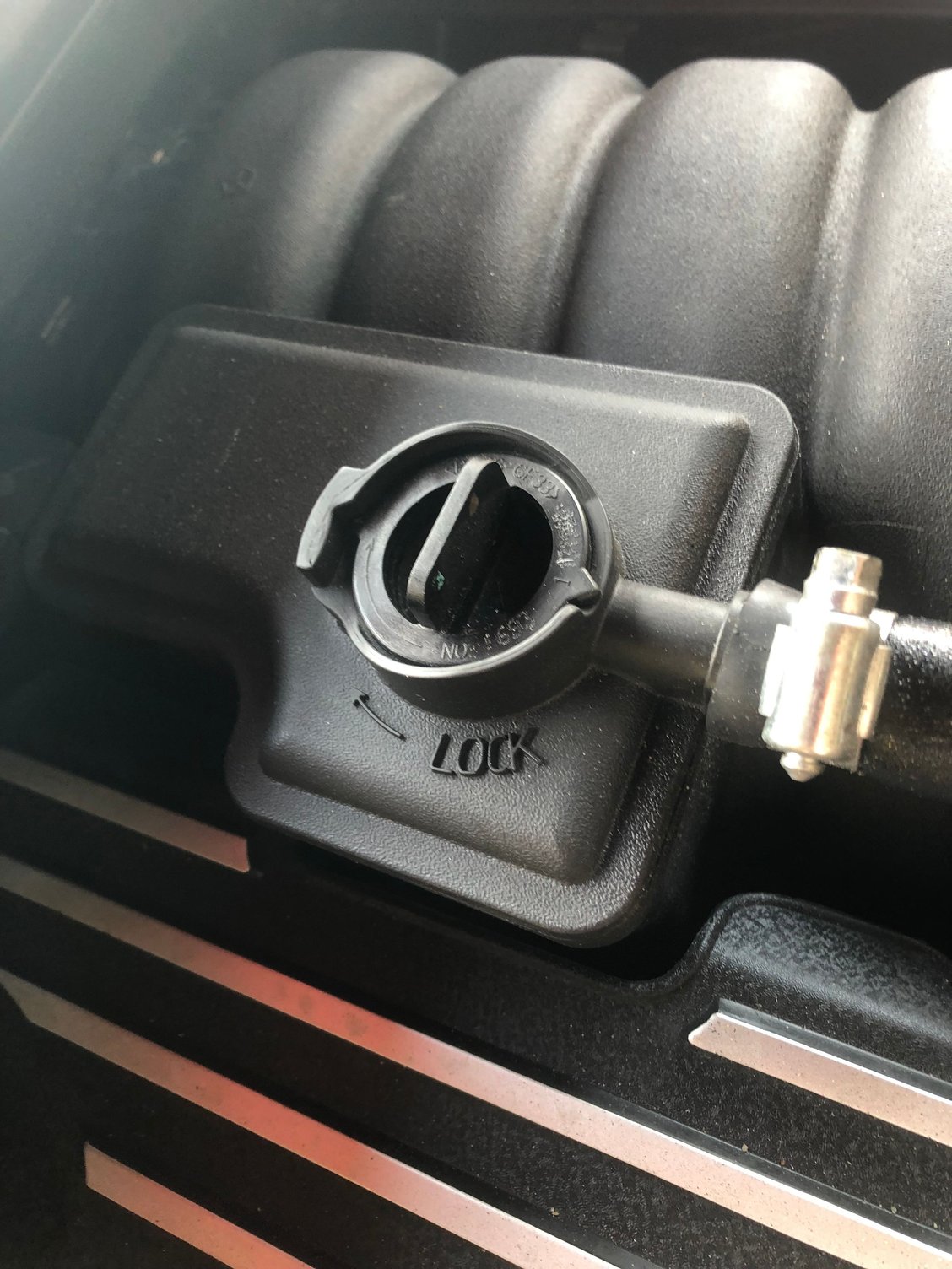

Can someone tell me what this is?it’s on my newly required 2014 Dodge Challenger

PCV valve....what idiot put a hose clamp like that on a plastic manifold?

Was like that when we bought the car and was pretty sure it was PCV but never seen one like it also hose is kinked and too short

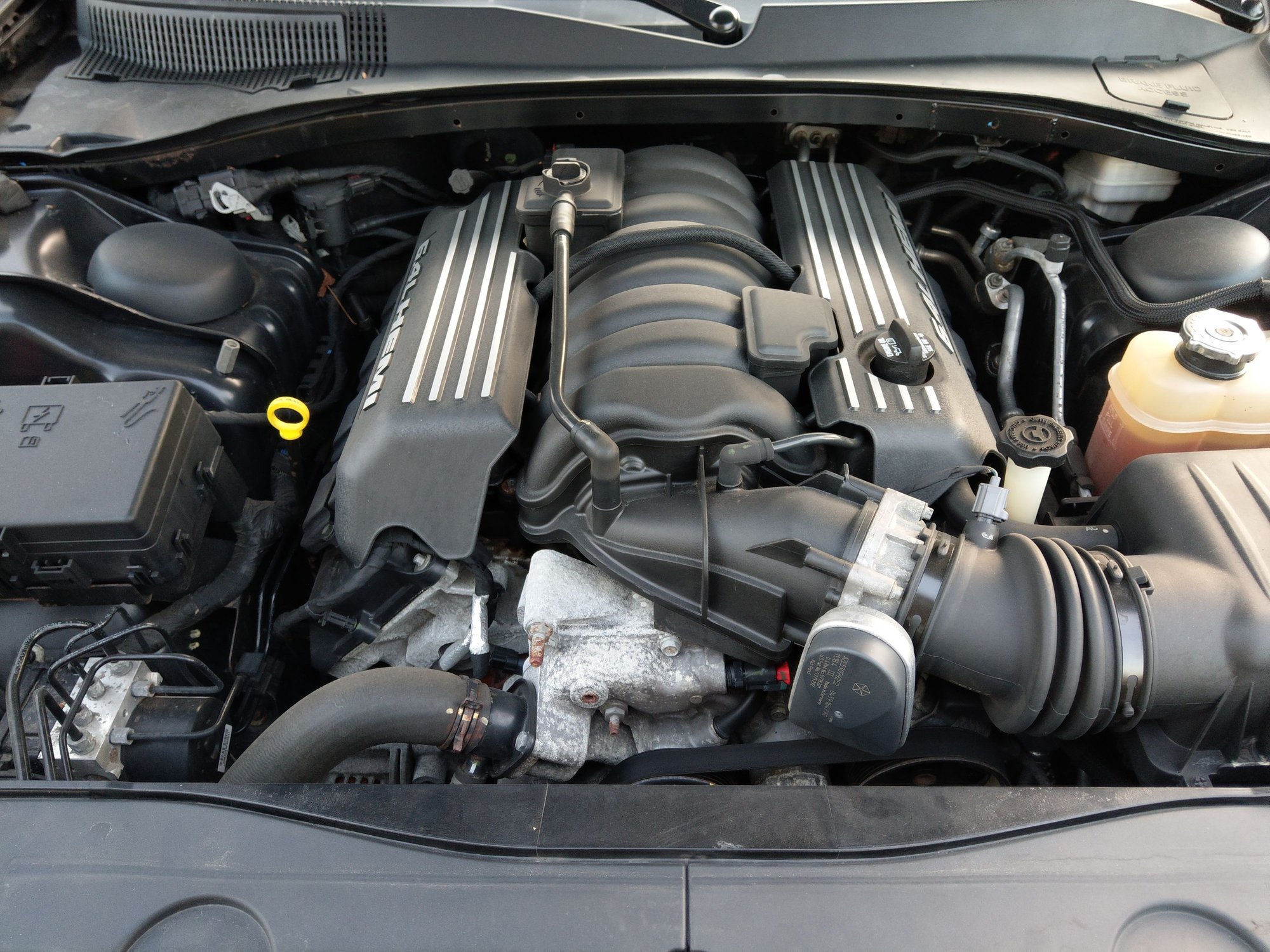

This is what it should look like unless there's a catch can plumbed in:

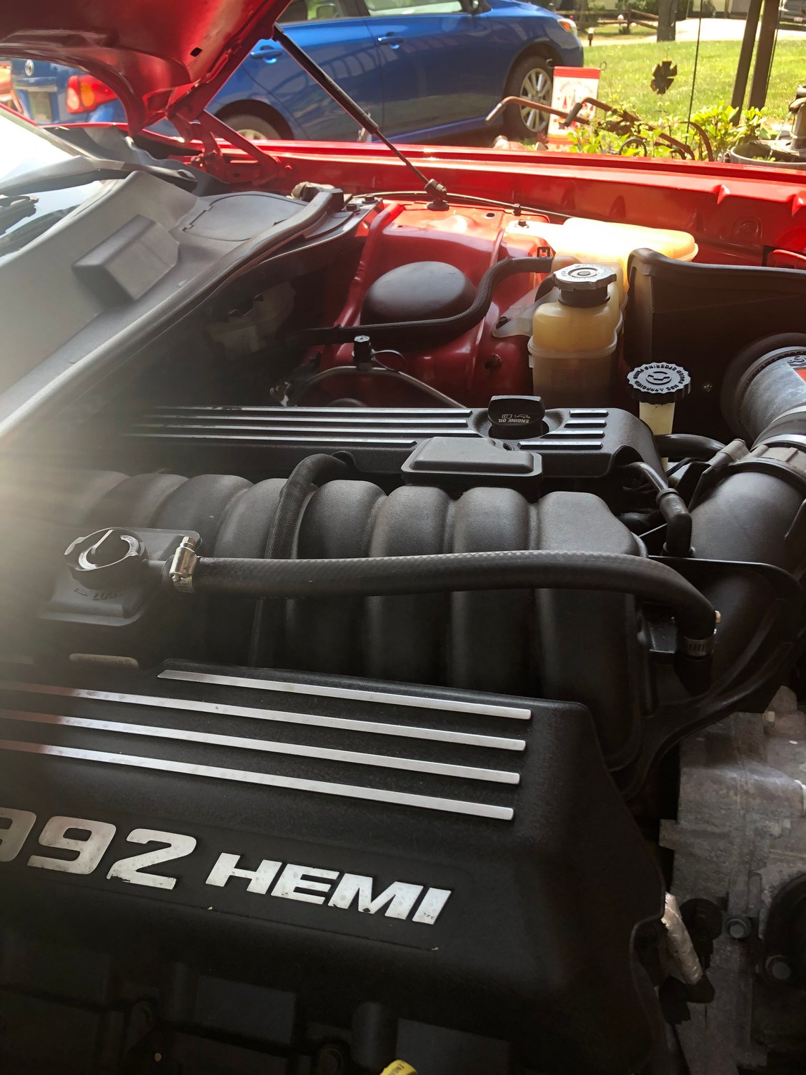

Thank you this is what it looks like now and will be fixing it right

Yeah. That’s an aftermarket rubber hose. Previous owner probably broke the OEM one.

Christ......guaranteed previous owner had a catch can on it and sold the can when the car was gotten rid of and probably lost the original hose. Part number 5038500AB in case you need it.
