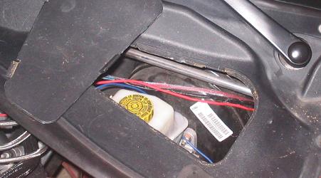

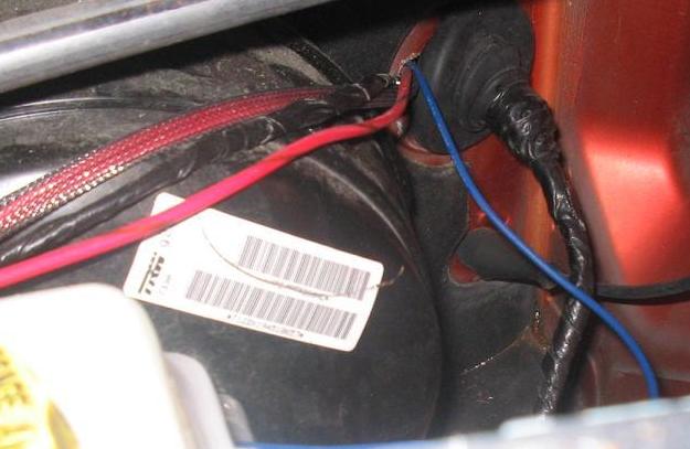

I have a 2008 Charger SXT. It does not have fog lights and I wanted to put some in. I want to put in those sick halo fog lights and just wire it up without going to the dealer. They want 200.00 for OEM installed. I can do it myself. but I was looking for the hole in the firewall to get the switch inside. Can anyone tell me or post a photo of where it is located? I think its on the driver side next to the brake resevoir?

Hey Stephens looks like you've posted up before but I don't remember saying hello and welcome to the fourm.
The place i ran my wiring has been where you mentioned on the driver side below to the brake resevoir.
I don't have time right now to look for a pic I took of my wiring but I will either find it today or take another picture to post up.

Here is a couple pics of where I ran my wires. It's right next to the brake booster.
Hope this helps!

Thanks for uploading those images, that really helps me out.
