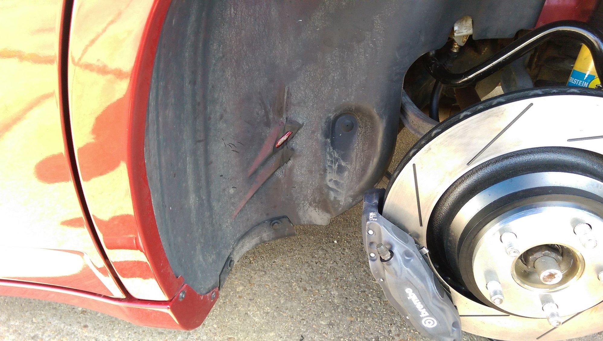

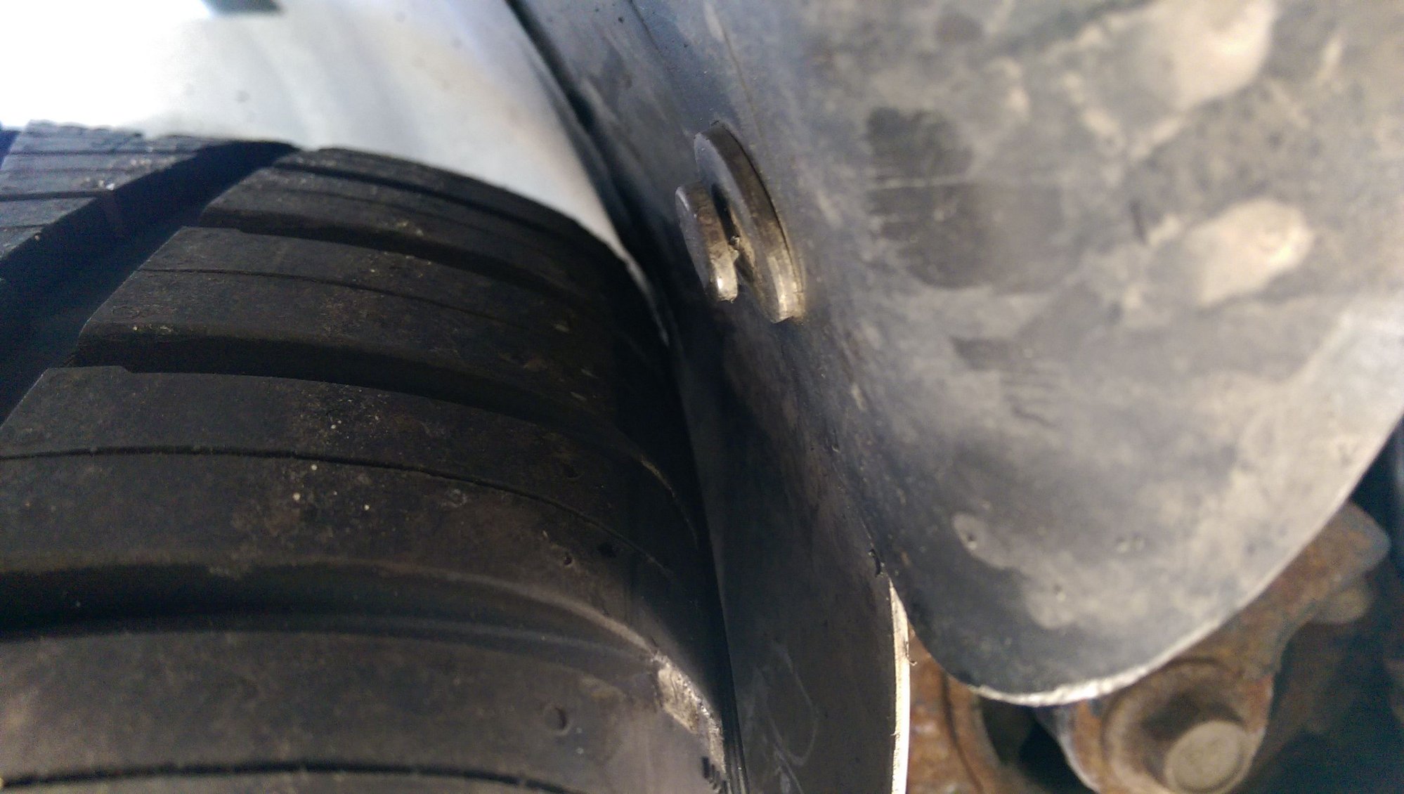

Aftermarket rims only with the correct offset. Stock SRT size that year is 20x9 and a 275/40R20 fits nicely, however on R/T spindles you won't fit that up front. Aftermarket 20x10's with the correct offset to clear everything exist, then you can generally fit a 305; 315's tend to be a bit too wide for the inner fender liners and you get this:
The only fix at this point is to get narrower tires or space them out til they stick out past the fenders.
