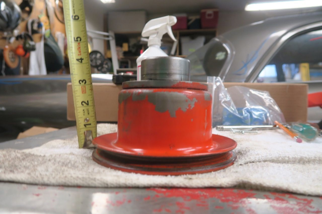

Hi everyone,
I have a 1960 Dodge Dart Seneca that I am trying to switch from manual over to power steering. My last step is to find a 2 groove pulley for the crank on the 318 motor. I took the old pulley out and it baffles me because it is like a one piece pulley/harmonic balancer that slides over the end of the crank shaft, has a key and gets bolted on by one big bolt.
Does anyone know if there is a 2 groove version of this type of pulley and where I might find one? Here are a few pictures to see what I am talking about. Any and all help would be appreciated.

There are a number of different lower pulley configurations. Your best bet is to go to the junkyard, with your measurements, & look for one. You will find the one you are looking for on older vehicles. Mostly late 70's & older. I usually take 3 or 4 different ones when I am doing a set-up. That way you have some options when you get home.

That is a 318 poly motor correct? The last year for them was 1967. Doubt you find one in a junk yard but it's possible. Might try ebay or hemmings, Not sure how much support those motors have.

Thanks for the info. I think I may have found one on eBay, but I'm having trouble getting any info about it from the seller. Can anyone tell me if these 2 part numbers are interchangeable?
My pulley #1859 680
eBay pulley #1735 924
