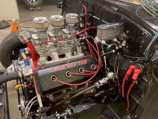

I have a rebuilt 1955 Desoto 270 Super Red Ram hemi that has a chirping noise in the engine. Most prominent at idle and seems to calm down as the engine revs up. Does not change when I pull individual spark plug wires or back off the vacuum advance by pulling off the connection. Sounded like it was coming from the rear of the pan so I pulled the pan to inspect. No signs of rubbing and the oil pump is quiet as well. I did notice that the top of the oil pump drive shaft was worn about 1/8" down. May need to shave some of the bushing off so it seats lower on the pump shaft. This would also give the distributor shaft a little more room from the top. It may be pushing down on the drive gear causing the chirp.
Any ideas? Thanks

1950 Dodge Wayfarer Sportabout. Has an Art Morrision front clip and am using Hot Heads Research motor mounts that tie into small clock Chevy water pump. I have unhooked all of the fan belts and the same noise is present. Thinking about unbolting the flex plate and running the engine to see if the noise is still there. I have close to 1/4" clearance between the flex plate and the new torque converter. Noise does not change much when driving.

Found where the chirp was located. The oil slinger on the crankshaft in front of the timing gear was bowed too much and was rubbing on the Hot Head Research timing cover. Getting louder as it was bending the slinger as it rubbed. I bent the slinger back so it will not rub any longer.
Could not hear the rubbing using a stethoscope. Had to use a rubber hose placed in the breather opening to clearly determine where the noise was coming from.
