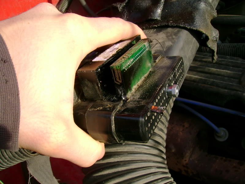

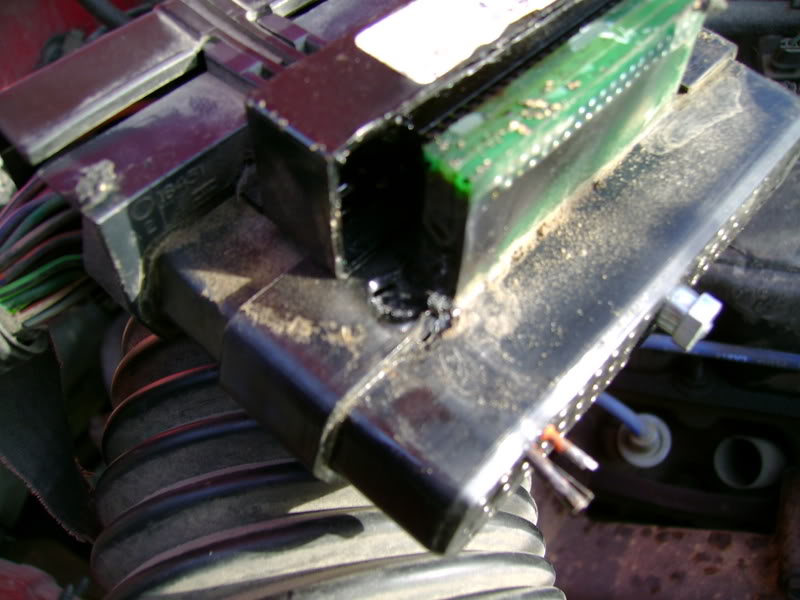

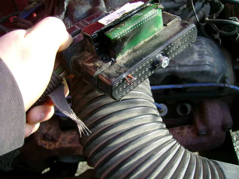

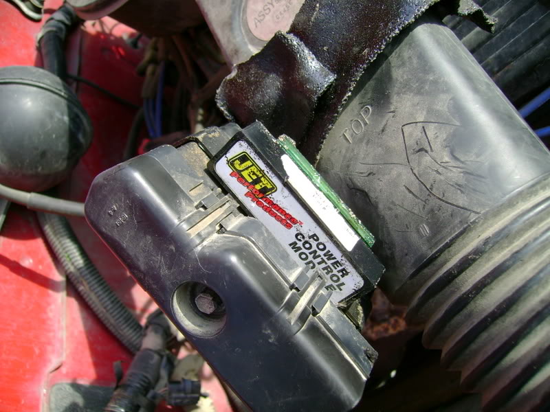

So it turns out that the fuel pump was not my problem. Nor was it anything to do with the distributor. The JET Stage 2 module I had installed over a year ago suddenly failed. And it's taken my computer with it. I've contacted JET's customer service, and asked them to refund me for the module and replace my ECM as well.

It took two contact pins and the entire nut and bolt assembly with it. I installed it correctly with no issues, and it ran fine until this Monday, so I have a hunch that the failure caused enough heat to fatigue the plastic directly around the plug area. The bolt wouldn't unthread (it turned but wouldn't come out) and when I tried working it gently by hand it suddenly pulled right out.
It smells pretty rank too...
