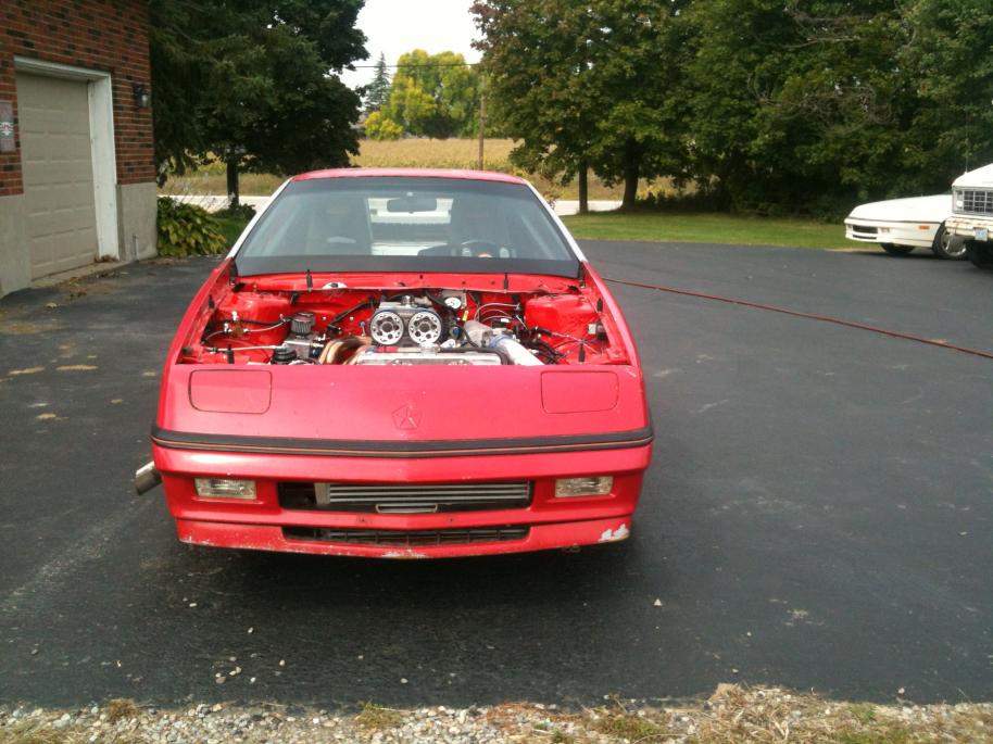

This my 87 shelby Z its a 2.4 turbo 904 8.75.
Attached Thumbnails Daytona rear wheel drive project ? ? ? ?-shelbyz2.4.jpg   Daytona rear wheel drive project ? ? ? ?-003.jpg   Daytona rear wheel drive project ? ? ? ?-005.jpg

Nice, i haven't been on in a bit too long.
Did you push the firewall back at all or just hang it within the area already available up front.
when you made room for the trans were you able to keep or retain the factory look inside ?

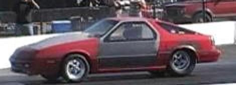

I have a 5.7 hemi in my 92 Daytona, with a 6 speed. its been RWD since 1999.
and it still gets hammered on!
I have pictures up on my web site if you need parts or info. www.exlinecustomauto.com
