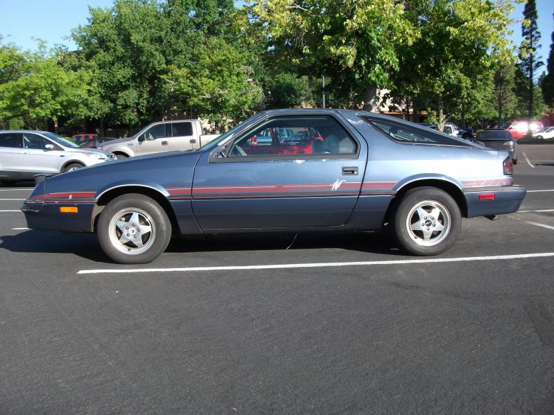

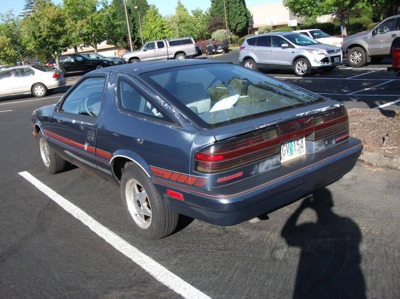

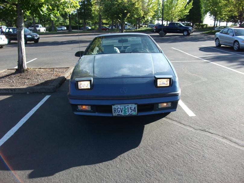

It's a 1990 Daytona 2.5, auto, air, no power on anything but the mirrors. My grandmother bought it brand new and I never really cared for it because I thought it was greatly underpowered. She put my name on the title in case anything happened to her it would easily go to me, so I'm partially first owner of the car. As time goes on, I keep getting more and more comments regarding the car - it seems to be growing on me. The parts are widely available, fairly easy to remove and install, and they are cheap. I have ran the engine out of water and oil ( the engine takes 4 qts of oil, and I put 4 qts of oil in the car before the level reached max on the stick!!! I know, I'm lame) and it still seems to be running strong. I am currently on the fence with my feelings on whether to keep the vehicle or not. For now, I will attempt the heater core removal and see where it goes from there.
