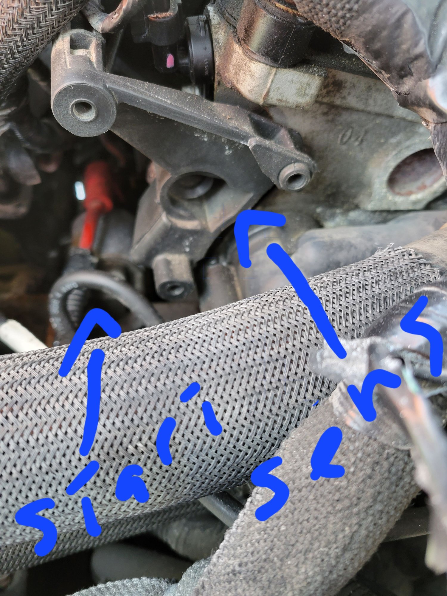

he says he saw a video where the guy had similar issues and it was a faulty manifold runner control valve, so he thought he would replace it only to find that this part was never installed in the first place, see picture
he says he cant even find wiring or connector around where it is supposed to go
