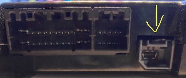

Does anyone know what this connector is for (on the Telematics module)?
