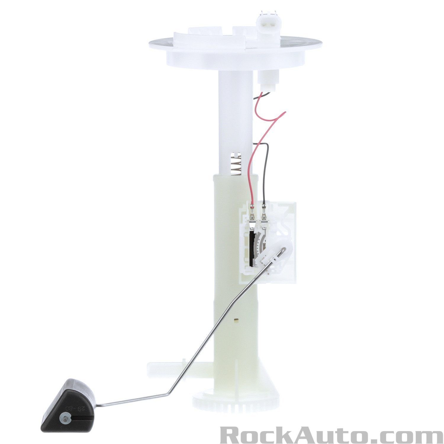

I assume it’s the 3.5 v6 engine because you talk about passenger sending unit. The 2.4 I think only has pump sending unit.

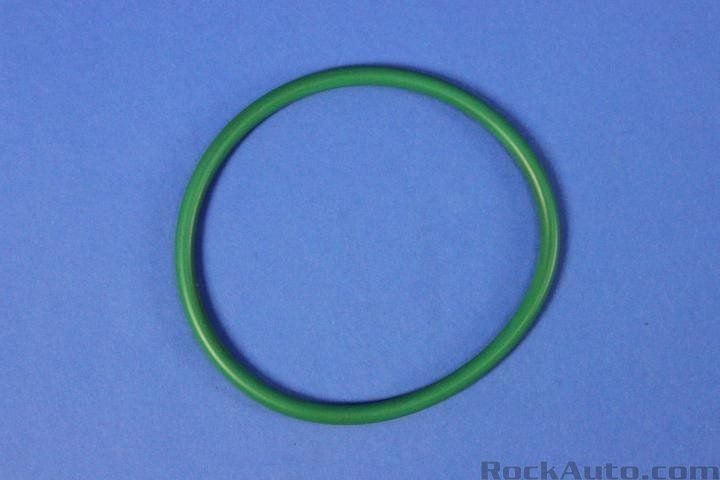

Rockauto has a listing for passenger sending unit, it’s in the picture. Not sure if seal is included, may need to get separately.
Seems like sending unit and bug oring seal need replacing. Tank could actually be topped up (gauge shows wrong) and o ring seal is bad and needs replacing. Run tank as low as possible if you diy the job. Gas is heavy. Need quick release fuel line tool, Harbour Freight maybe.

Comes with new gasket , listed in description.
DELPHI FT4020 Specifications Fuel Level Sender Assembly Included Yes Fuel Type Gas Gasket or Seal Included Yes In Tank or External In Tank Outlet Outside Diameter (IN) 0.500 Outlet Quantity 1 Outlet Type Quick Connect Package Contents Fuel Transfer Unit w/Float Arm, Seal, Instruction Sheet Position(s) Right Regulator Included No Resistance Ohms Empty (82) 250.0 Resistance Ohms Full (82) 40.0 Strainer Included No
