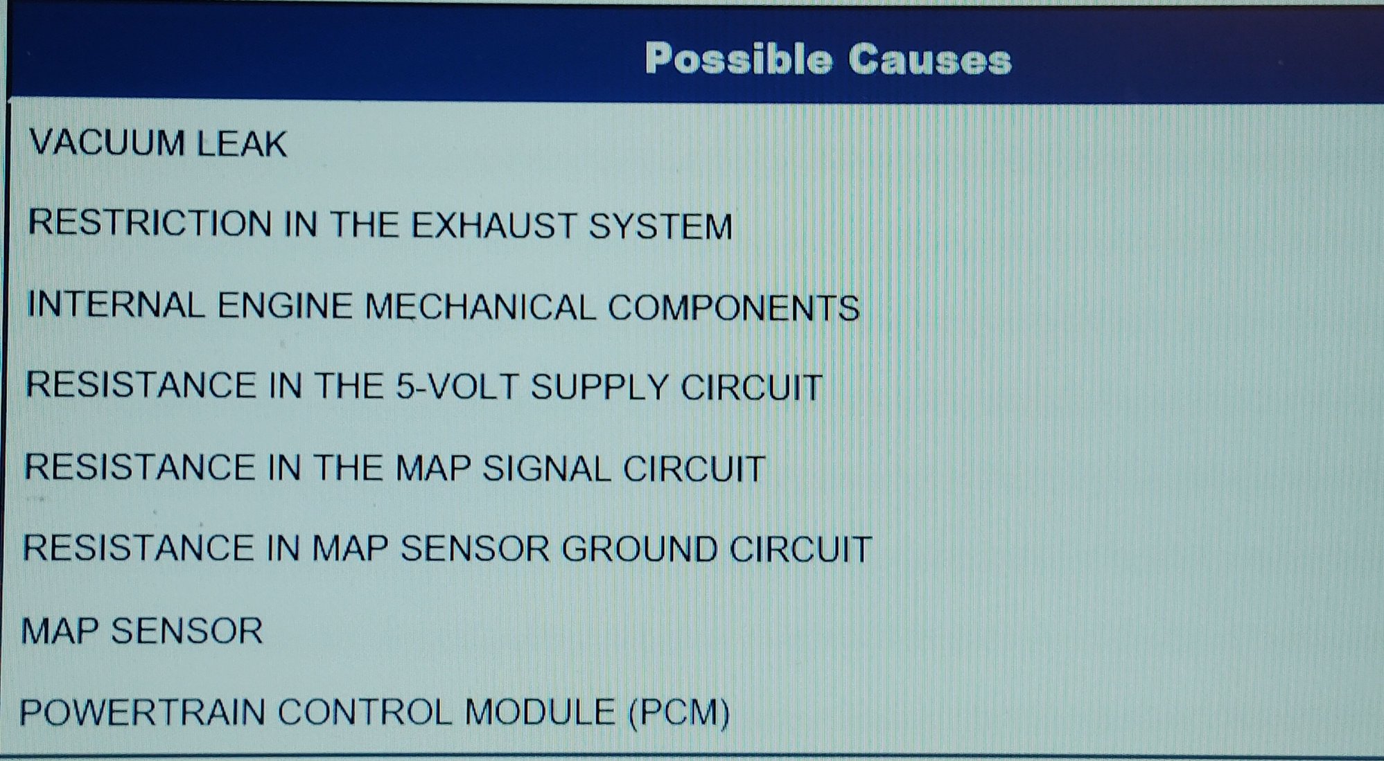

This is the list from Dodge for code P2173.
Start easiest -
I would exam the air intake tube carefully.
Check the vacuum line into the map sensor and brake booster. Any other vacuum lines there is.
Have you smoke tested the engine intake manifold and throttle body?
Start easiest -
i ran the smoke test through the vacuum line to the valve cover. For at least half an hour. Smoke was coming out the air inlet port at the front of the hood. Only leak was oil fill cap I replaced that. Appreciate the response. The exhaust pipe is separated but it’s under the center of the car. I don’t see how that can cause this p2173. I guess because there is no maf the map sensor is used to detect vacuum leaks. back pressure in the exhaust affects crank case pressure. Your list for p2173 says exhaust restriction as a cause. That would increase pressure. But I guess not enough pressure could cause it too. I’ll put a temporary wrap to seal the pipe will see what happens. I’m really starting to appreciate having a MAF sensor in cars. Any machine you can’t figure out gotta fix what’s obviously broken if it’s even remotely related to the problem.
