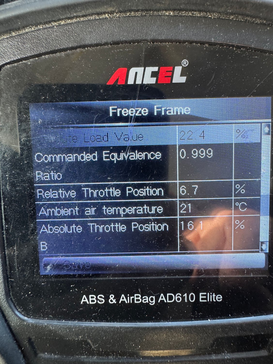

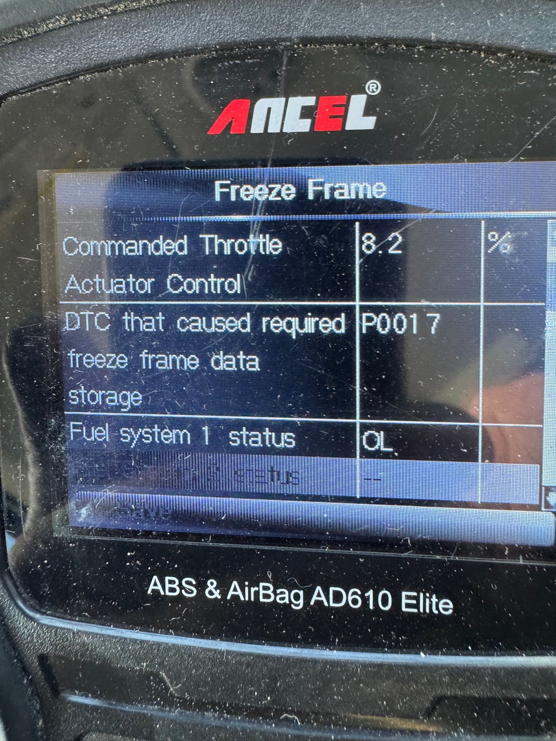

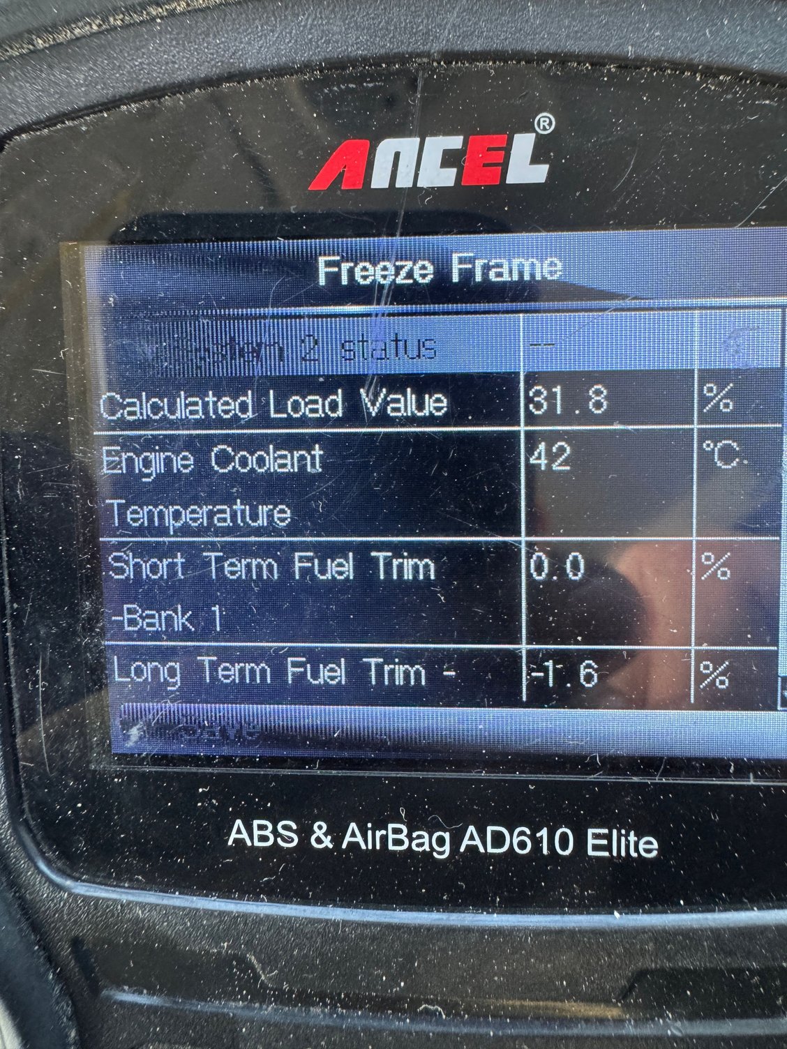

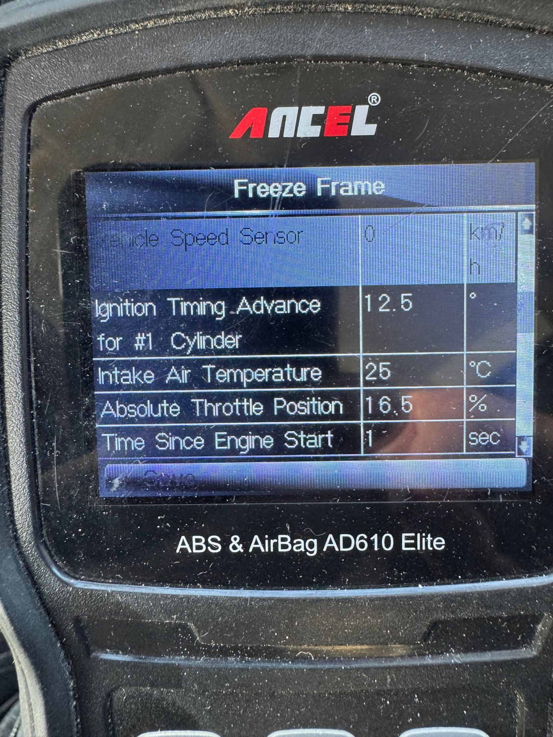

I have 2010 dodge journey SE, 2.4L automatic in Limp mode, revs to 4000 rpm, releasing gas pedal slightly helps shifting, lacking power, plugs, coils, good, no misfires, vvt’s, cam position sensors changed or tested on ohms. Wiring checked 12 volts, could this be caused by TPS, or any ideas. Timing chain?
idles smooth, no knocking or pinging.
code reader Freeze Frame photos uploaded
