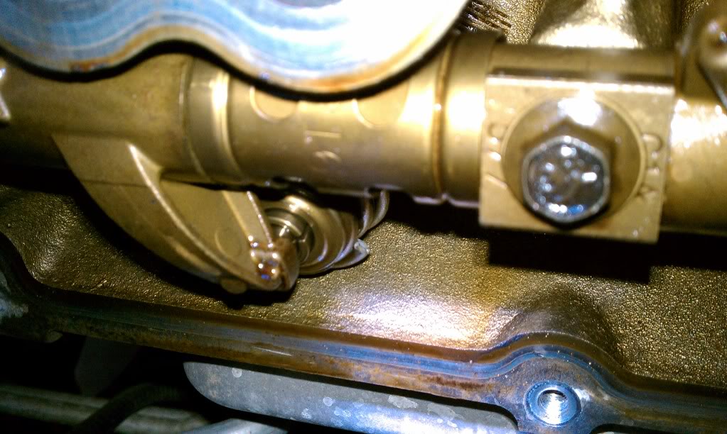

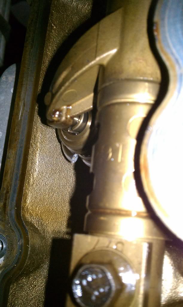

ok Update removed driver valve cover and found a broken spring here are some pics Name:  IMAG0204.jpg
Its the bottom left spring in this picture
Now the question is how hard is it to change? I've changed them before on my honda but this looks different any advice will be great

There easy enough to change. A good enough air supply to keep the valve up and block the oil returns at the bottom of the head so you don't lose a keeper.
