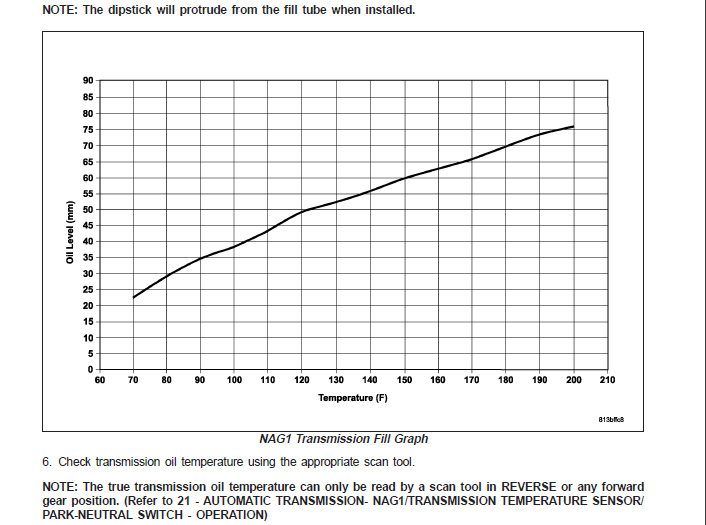

Holy mother of run on sentence...........I HATE talk to text because it records exactly how people talk and leaves it that way. I shall attempt to dissect/decipher:
Originally Posted by Swansonb007
My question to you is I've never changed the transmission fluid and I do have the correct dipstick to read the levels, however does no good when you don't know what ever little measurement slash should read when engine hot, cold, ect or at this point is it worth even risking trying to change
Fluid fill in the NAG1 is directly related to trans temp, like so:
