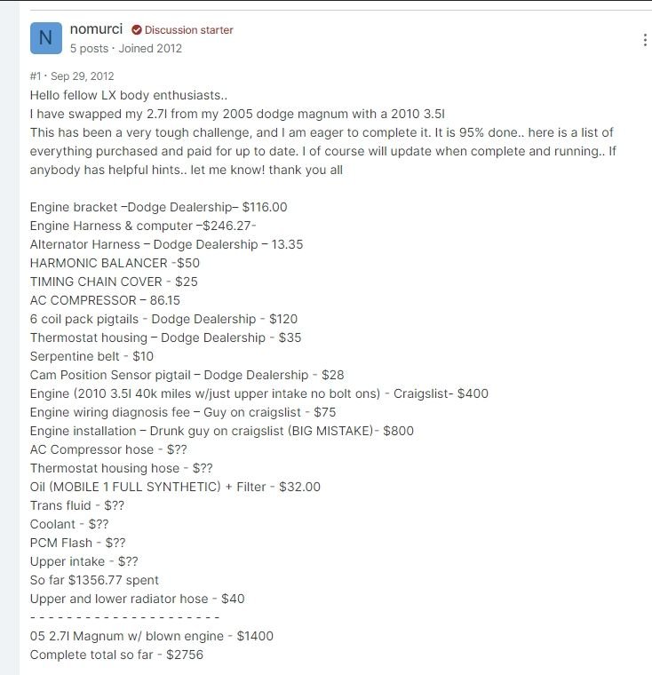

But, TLDR, yes. All you need is the engine harness. BUT, there are many changes and differences between years and trims so be sure to get the right one for your engine!
https://www.chargerforums.com/thread...1#post-4644073
So really, this is your question. And a quick google for "Dodge 2.7 to 3.5 swap" comes up with many forum posts, YouTube videos and the like.

I appreciate, also, that your results may not have been mine, as the following posting with the 'list' is not one I had seen, and I have been looking for a while.
Quite frankly, engine-swaps are not new to me, but most of my experience going that deep was on cars pre-computer [like my '70 RoadRunner], and the issues with this one have been 'above my paygrade', as it were, because diagnosing and fixing 'tron issues is not unlike learning Spanish - I may know the words, even some of the definitions, but my problem is building complete sentences in this foreign language, lol!
Thank you for the link to the other thread, there is a lot to unpack there, very helpful.
