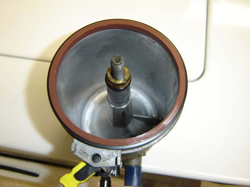

I installed the 150/95 FASS and I love it. I too was concerned with by-passing the stock fuel filter not because I wanted to further filter the fuel, but because I wanted to retain the use of the fuel heater. To be able to still use it but to eliminate the filter, I had to cut the top off of the old filter to use the top part because I needed the gasket to seal it up. Here's a couple of pics ...

I then ran the FASS line to the stock inlet at the top ( where it used to come from the stock pump ) and from there the fuel continues to trave out through the stock line out to your CP-3 as usual.

Fill the canister with diesel fuel before screwing it on and you'll be good to go.

It really worked out well and I don't think it effected my fuel pressure at all ( 13 - 14 psi ) The fitting that comes with the FASS screws right into the top of the canister so I didn't need to pick anything else up at all. I used hose clamps as you can see but I've been told countless times that I didn't need to with that blue hose.
