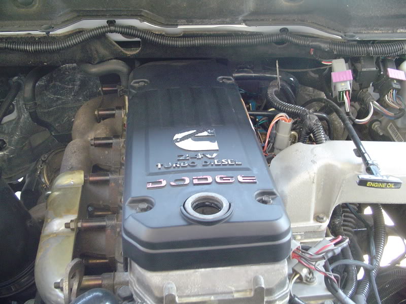

i just went outside and snapped a pic of my exhaust spacers (or atleast thats what i thought they were[:-]) and if they are the exhaust spacers you were talking about super dave they look almost asif they are burning uneven... the ones towrds the front seem to be darker than the ones sin the back but maybe i see it wrong?!?!
