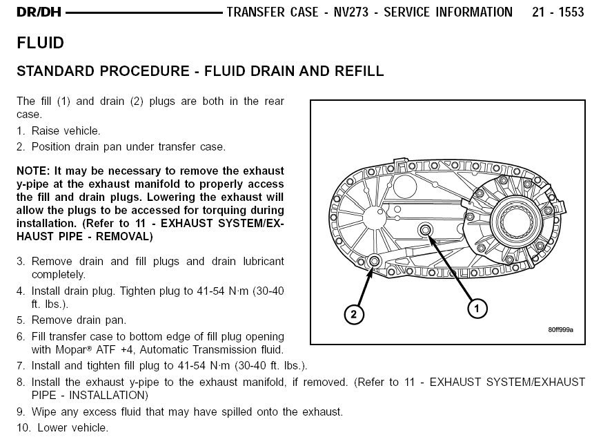

25 to 35 ft pounds torque for fill and drain plug. checked the manual on hemitruckclub

Yea those are it, it is a real pain in the a$$ to fill though

Even with the fluid pump?
Old Nov 17, 2007 | 12:03 AM
DiEseLjunKy's Avatar
DiEseLjunKy
Joined: Dec 2006
Posts: 432
Default RE: transfer case drain and fill
I torqued mine by feel alone and have had no problems.A pump is a must with TC, trans, or diffs imo. I put amsoil in all my drivetrain components and the $15 I spent on their pump was the best $15 I ever spent.Belive me if you don't use a pump you'll end up spilling $15 or more!! of oil on the ground.

Hmm, good idea. Why did I put mine away right after I finished my axles...........[:@]

Here is a shot from the 2005 Dodge Ram Service Manual.
