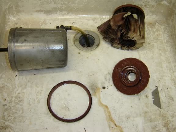

I never ran the FASS with the stock filter in place so I can't help you there. I still run the fuel through the empty stock fuel filter housing though. You'll hafta cut the o-ring off of the stock fuel filter to do that though. I ran it this wat so that I can continue to use the fuel heater.
