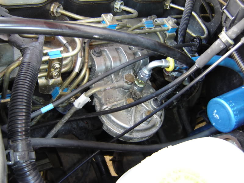

Yeah, we should have the same filter canister. It's not that difficult to change.
Look at the center of the top and you'll see a nut. Unscrew that nut and the filter cnister will drop from below it. The lid to the canister stays put. Basically there is a long bolt running through the center. Before you start thoug, you'll want to drain the fuel out of it with that yellow lever.
This is what it will look like when you remove the canister
This is what the canister and filter look like. Well ... not the filter because in this filter I cut it all up, but you get the idea
This is what the inside of the canister looks like ( minus the brown lip that I cut from the old filter )
The reason I did all of this was because when I installed my FASS I ran the FASS lines through this canister because I wanted to continue to use my fuel heater ( located at the bottom ... you'll have to unplug it before removing the canister ). I had to cut that top lip off of the fuel filte because it holds the gasket that keeps it from leaking. My fuel filter bowl is now empty ( except for fuel ).
When you re-install the new filter, fill the canister with fuel before screwing it back on. This will help in the priming process. Before starting the truck, bump the starter a few times to totally fill it up. It's take a few tries, but eventually the truck should fire up.
Best of luck. Any questions, feel free
