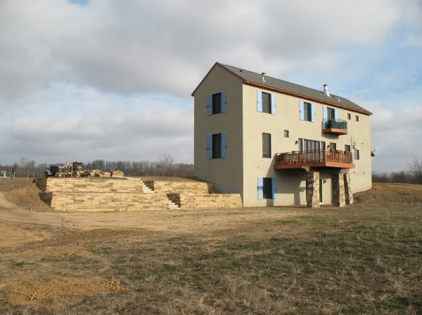

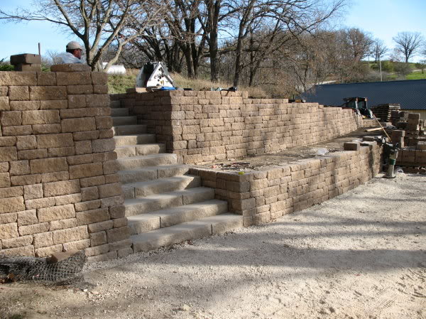

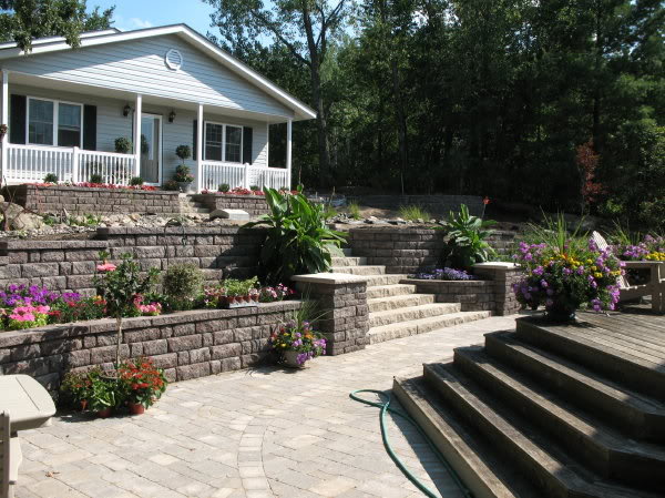

Here are some pictures of last years projects.
