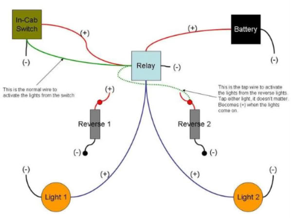

Donny,
Check this out, it should help

Can you explain a little more about how you did your wireing?
Red goes to the + on the battery, black goes to -

great idea but am i an idiot or is that ground conection secure enough i think i would of put a bigger one on take the nut off and put it on the bolt . ive seen too many times those little donuts cummin off like that just a sugestion

No you're not an idiot ~ none of our circle ends were big enough for the bolt. It is in the plans to correct that but just hasn't gotten done. Each light is grounded seperatly and the swithc is also grounded. So there are several points in the system to ground. There is also a in-line fuse in the hot from the battery. So if all else fails that will pop
