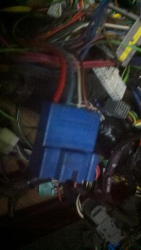

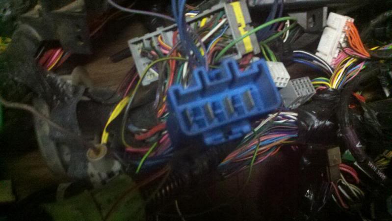

If the connector you found looks like the one below, you have found the trailer brake connector.
Do not have a wiring diagram for a 1993, but do have for 1994. In 1994 the instrument cluster has 2 connectors, 1 white, 1 black. The black connector has a grey wire with light blue tracer that is the tach signal wire. Hope this helps...

nope not that one,, that one has allready been used for the light w/ the elect. trail. brake system.. i found the plug i need, thanks,, will wire when the tach gets here
