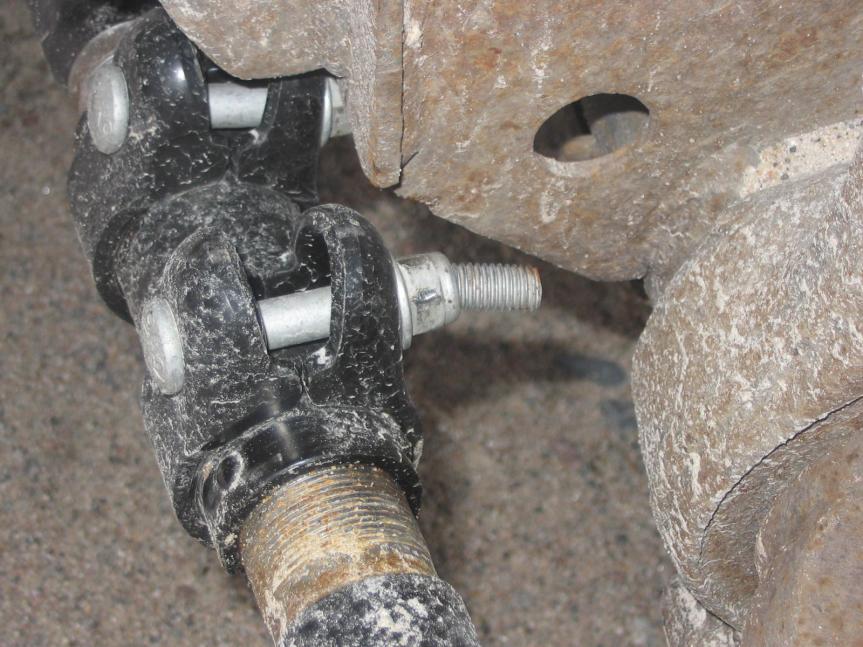

I have 111000 km and never had an issue with Death Wobble until after this recall for the left tie rod end was done. Had one instance of full blown wobble, went to dealer who said alignment was off (their fault). Still had right drift in steering after alignment was corrected and double checked several times. Also front end shake for 2-5 seconds after hitting bumps at 100 kph. They admit something is wrong but have yet to find out what. Could the alignment still be out of whack ? I'm beginning to wonder if their machine is out. Any thoughts? By the way , I've attached a picture showing one of the adjustment bolts that I discovered was bent after the recall. They replaced the bolt and turned the collar around to prevent interference of the bolt again.

Got the truck back after a week. They replaced the tie rod end at pitman arm. I have driven about 800 km now without any more wobble. Hope this lasts! Still have a bit of right pull but could be road crown.
