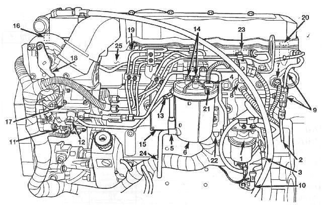

Yes, a fuel pump is typically called a lift pump on a diesel. If its not buzzing for about 25 seconds on key toggle it's not functioning. The reason it's called a lift pump is there is a separate injector pump that's commonly referred to as the fuel pump or better yet the high pressure pump.
The lift pump is prior to the fuel filter bolted to the block. I'll see if I can find a diagram...

(1) is lift pump location
(17) is injector pump location
