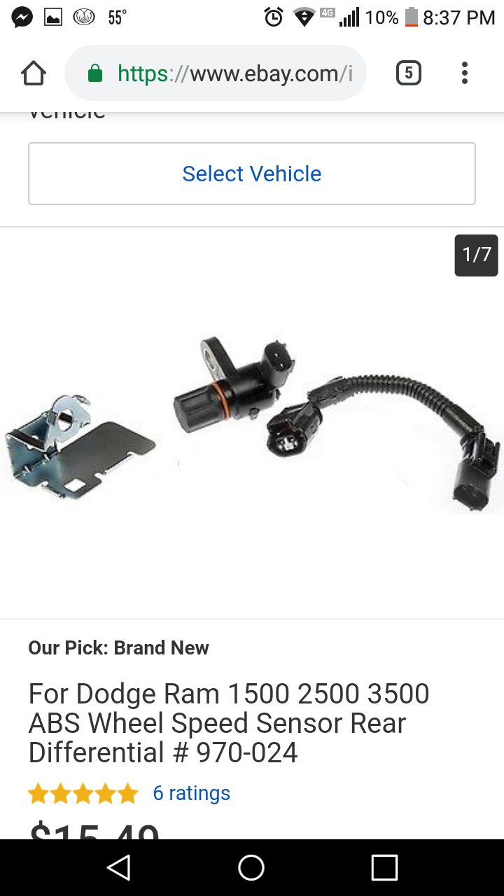

Trucks a 1998 dodge ram 3500 12v 47re so here is my issue the truck starts off in 3rd gear i can shift to 2nd manually but not 1st if I go to neutral then 1st it will go into first and the truck will only shift to overdrive and lockup sometimes but when it does it wont downshift unless I go to neutral then drive or down to 2nd my speedometer doesn't work sometimes it just bounces around or it floats up and down there are 4 codes that are coming up on the code reader i have attached a photo of the codes I just need help on what to buy to fix my problem im also including a photo of some kind of resistor on the pcm that the previous owner installed and some kind of overdrive controller that is on the truck as well as a noise isolator also in the pictures are the parts I think I need to buy to fix the truck
