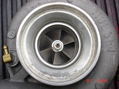

Where is the silencer ring? Is it actually in the opening of the turbo? I can't believe I missed that when I put the torque tube in. Also, if you don't have any hills, will some hard accelerations and burnouts work for the wastegate and fuel mapping?

when you pull the intake tubeing off this is what you will see
the silencer ring is the silver looking piece that is heald in by a snap ring. a flat head screwdriver will pop the snap ring out since it is beveled on the edge.
when I pulled mine out I put it underneath the rear seat and havent touched it since.

I'll be working on that right after work tonight, you can never be too loud with a Cummins. That ring will look nice in the garage with my other stock parts.
